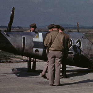

Late war color 109 reference (G series) to judge white opacity

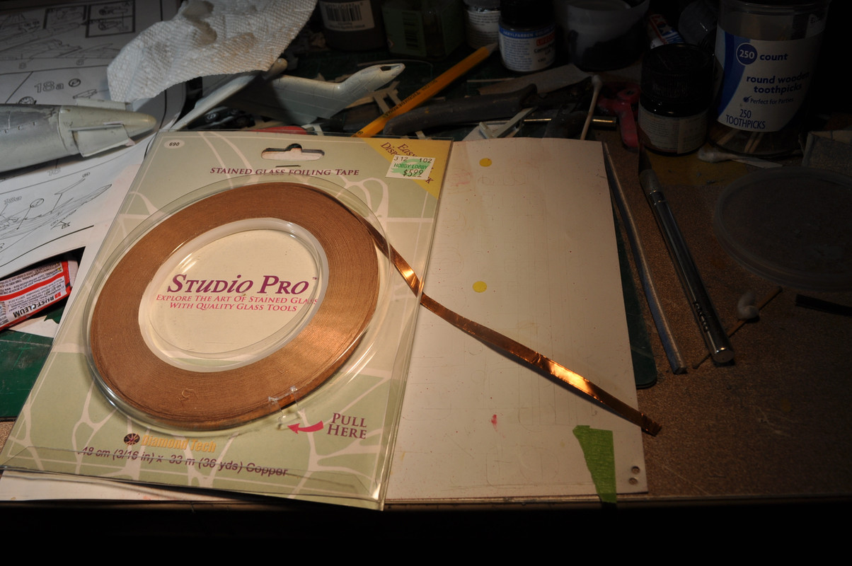

do you have any lead foil tape? I can send you some....for seat belts, etc.
No I don’t! I never heard of it either. My lack of aircraft modeling basics is definitely showing. Is that similar to wine bottle foil or something totally different? And thank you for your offer, Lyle!
I guess it is very similar to that....the wine I drink, when we do usually has a screw top... :whistle:
This is the lead tape - self adhesive backing, can be cut with a sharp knife or scissors. it is 1/4" wide
This is copper foil, used in stained glass work. No adhesive backing. This is 3/16" wide
Lyle, Thank you for the photos! I could easily see how dear belts and a lot of other parts situations could be adroitly handled with each.
