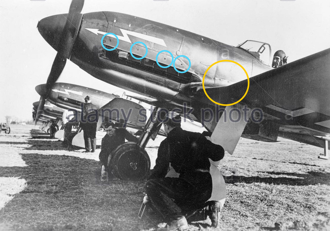

Image From “Heinkel He 100: World Record and Propaganda Aircraft,” Hans-Peter Dabrowski, author
What I see are large fasteners at the engine exhaust mounts and wing roots. Whatever these are, they will be visible in 1/72, and I will most likely drill out openings.
Re: Heinkel He 100: Intercontinental Friendship Model Shop P
Bruce, I can't say for sure but those look similar to Dzus fasteners, used on parts that are frequently removed.

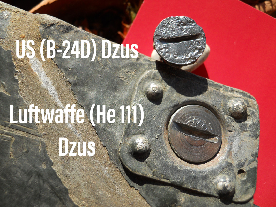

jeaton01 wrote:Bruce, I can't say for sure but those look similar to Dzus fasteners, used on parts that are frequently removed.
I love the internet. Crash materials comparing US and German made Dzus found at crash sites. I added the text to make the comparison clear:

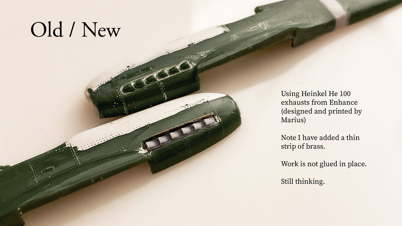

Well—
A package arrived from Germany today.
That is some nice looking exhaust
Posts: 21298
Those exhausts are a definite improvement! The brass strip will be good if the real aircraft had such a feature.
