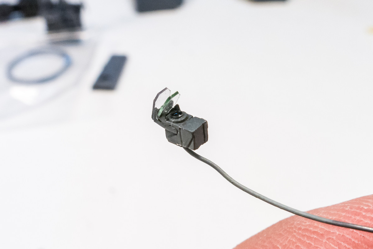

A bit more work on the Komet... instead of the kit-supplied gunsight or the one included in the Aires resin cockpit, I chose to use a Quickboost Revi-16 gunsight. The optical glass is cut from a sheet of clear packaging with the edges of the front element painted in transparent blue/green.
The mounting base from the clear kit part was grafted onto the bottom of the resin gunsight. There are visible stress marks on the transparent armored glass... I have an extra transparent sprue courtesy of Meng customer service so I'll probably utilize it to fix this issue.

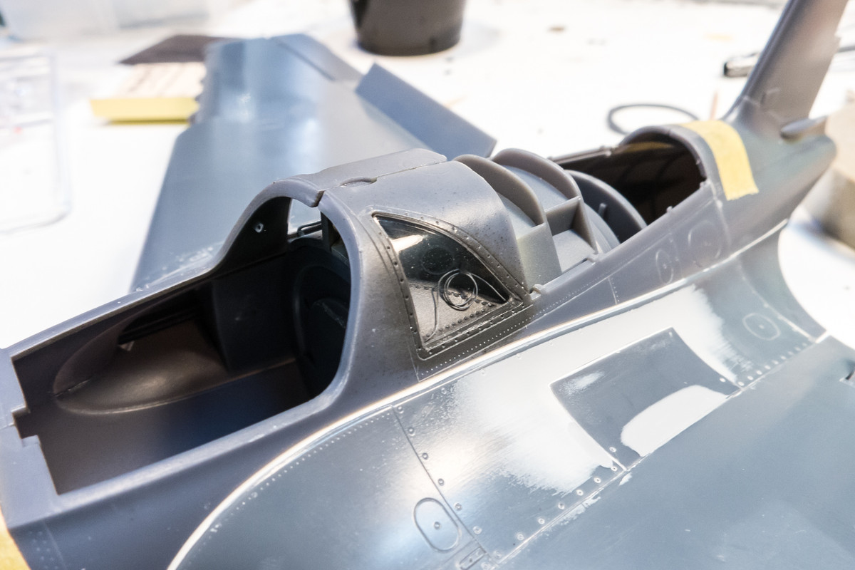

I've decided to glue in the side windows at this point and then mask them off for painting. I REALLY don't like Meng's choice to mold the windows and canopy WITHOUT the surrounding frame. It makes for a tricky and most likely noticeable glue joint.
And as previously mentioned, the three-part set of panels along the top spine were glued together instead of trying to glue them in separately later.

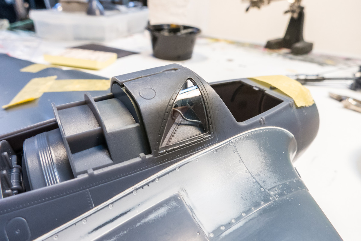

Another shot of the gun sight after replacing one of the armored glass plates. I also had to reverse the gun sight as I had glued it on BACKWARDS. Funny how many Revi 16 gunsights I've installed and how normal the backward one looked to me even when reviewing the photo. I must've have some sort of visual dyslexia.
Hmmm... actually, there really isn't much filler. There IS a large amount of light grey around the upper wing roots but that is just grey primer that was sprayed when I glued in the cannon bay covers and wasn't sanded off.keavdog wrote:Whoa - that's a lot of filler and sanding.

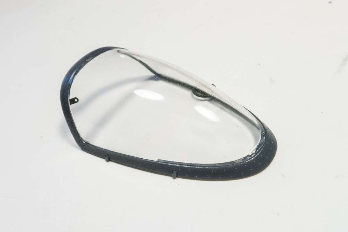

Here is the two-part canopy. The clear part, dipped in Future to enhance clarity, has been glued onto the canopy frame by carefully seeping Tamiya Extra Thin into the seam. I'd much rather have this molded as a single clear piece like almost any other manufacturer would have done. Why reinvent the wheel?
