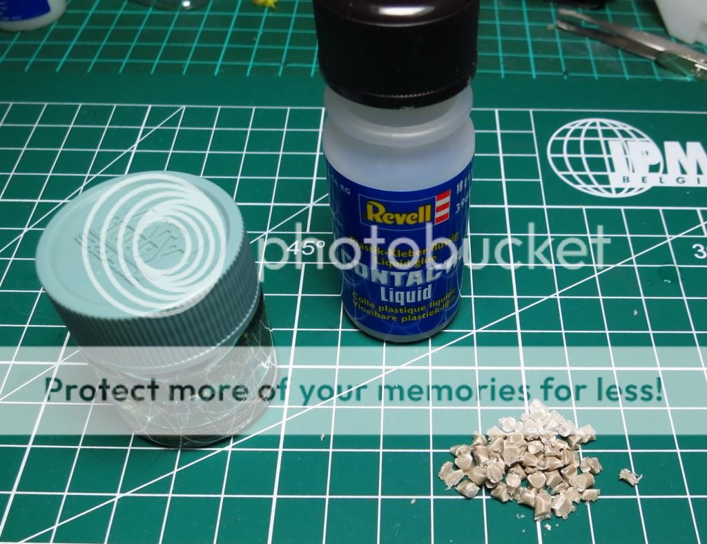

I got also very curious of this and having an "extra" bottle of Revells Contacta liquid, I decided to "cook" a little bit.
Did exactly as Lyle instructed... cut from a sprue (Eduard) small pieces/pellets, "a tiny handfull"...
I think already here there differences can occure.. Plastic from soft / hard plastic... Different colours etc...
And poured them all into the jar, 1/4 filled with Contacta Liquid...
Almost immediately things started to happen...
Aaand, only 2 hrs later I had very liquid styrene..
Though, I need to add some more "pellets" to get the stuff a little bit thicker... At this moment thickness is like cream..
Had to "smash" with a stick lumps, but otherwise very easy process! Well, so far...
... to be continued...

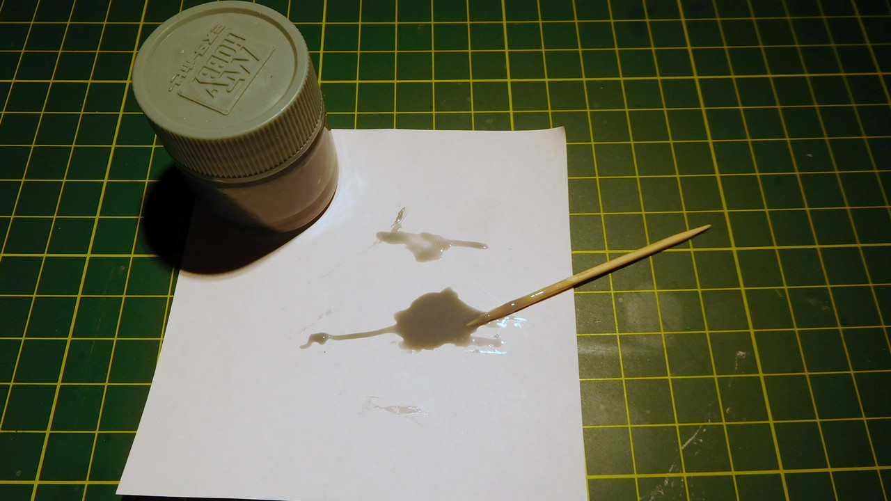

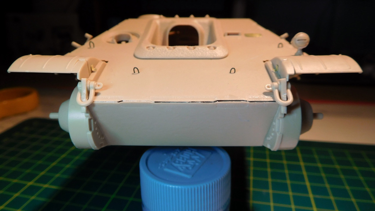

I "found" a pretty ugly gap in my Jagdpanther, so instead of using stretched sprue to fill the gap, I decided to go for liquid styrene or "Sprue goo" as it is better known..
The mix is similar to the one I made back in June 2014, but this time using TET and Eduards grey sprue.
I think I will still add some sprue pieces to make it one step thicker, but not much. Idea is that it would be sort of self leveling..
And here the annoying gap...
Soon that gap will be history....

I found that sprue goo is good for very small gaps or filling shallow ejector pin marks. Since it's a filler with high shrinkage characteristic, on gaps bigger than let's say 0.5 mm I use it in combination with stretches sprue.
