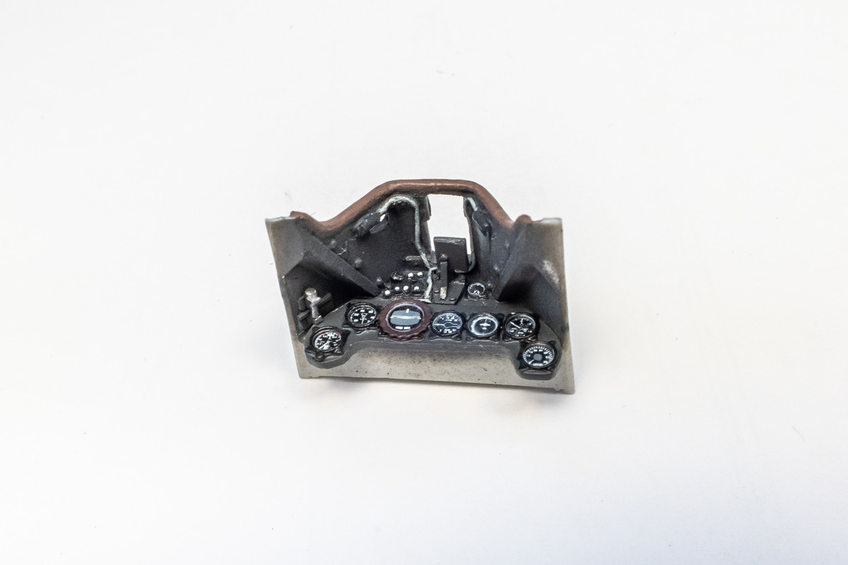

I received a couple of additional sets of Luftwaffe instrument panel decals by Airscale so I finished up the instrument panels. Here is the main instrument panel fresh after applying the punched decals and soaking in Microsol.
Since the resin instrument bevels are deep enough to accommodate this, I like to punch out discs of clear acetate to place over each instrument.
I even did this for the lower instrument panel with the instrument dials as small as 1.0mm
The instrument panels are done!

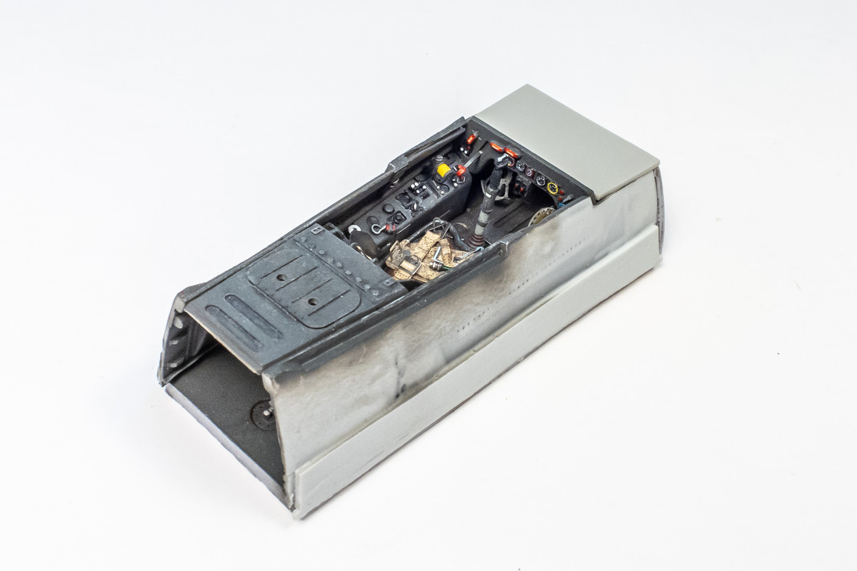

The cockpit tub and sidewalls have been given additional weathering treatment. I applied a brown pastel wash over a flat finish to purposefully leave some stains. Similar to working with oils except I don't have to wait hours for it to dry.

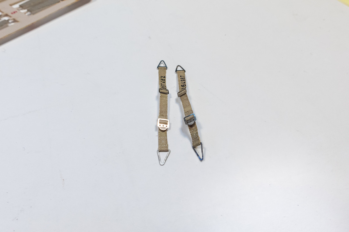

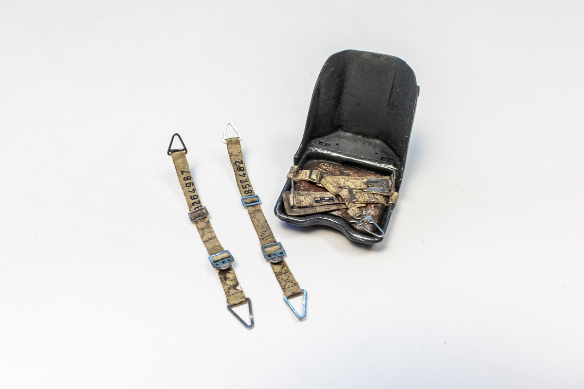

Moving on with the cockpit construction, I am ready to put together the HGW seatbelts. You'll notice the packaging says Me262B... I like to buy Luftwaffe seat harnesses for the two seater because you get two sets of belts instead of one for a similar price. Most Luftwaffe fighters used the same type of harnesses. The mask set? Well, that's all they had in stock.

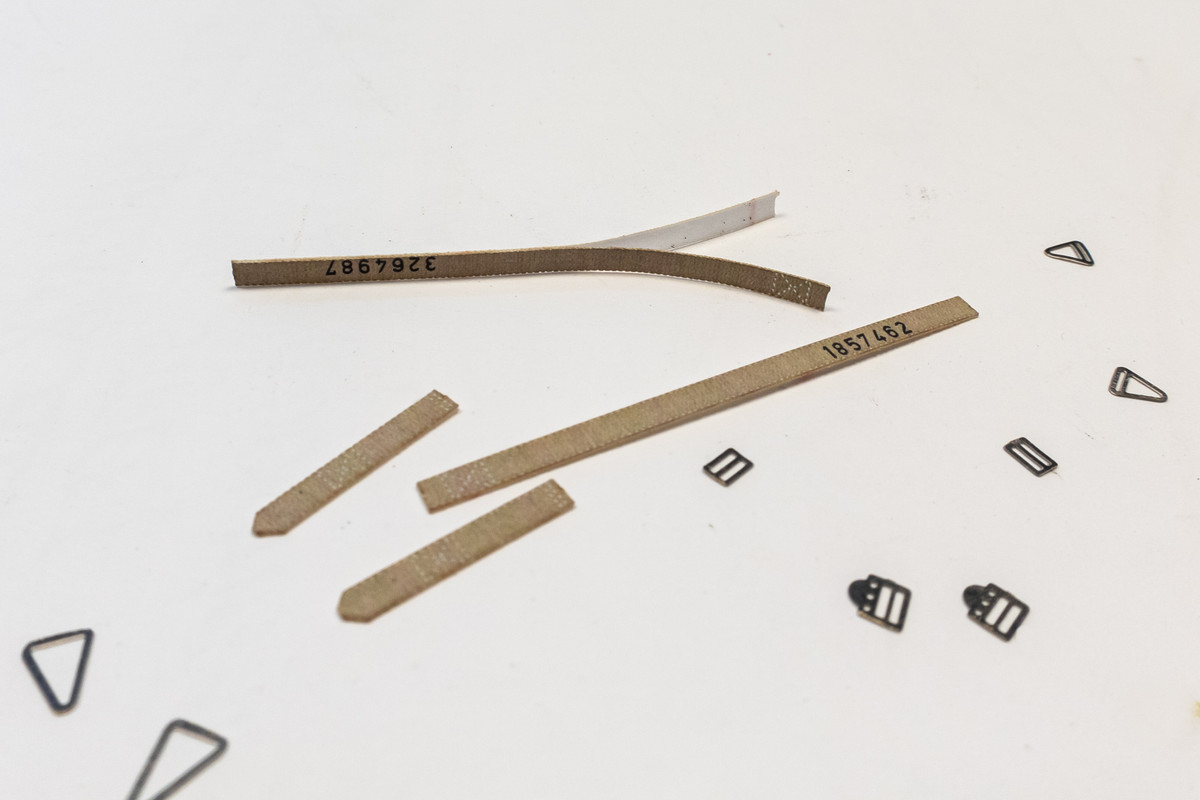

HGW uses some sort of microfiber paper for the belt material and photoetched metal for the buckles.
Some people report leaving the buckles on the photoetch frame for easier handling but I like to cut the buckles off and carefully trim off sprue attachment stubs.
Remember to take off the backing from the harnesses!
Per HGW recommendations, I like to crumple the harnesses before using. It helps loosen the material up a bit and also introduces some random folds and wrinkles. These effects are most noticeable on the longer pieces and sometimes I don't bother crumpling the shorter sections.
I use PVA glue to secure the harness folds that hold the buckles in place. You could also use CA glue but the PVA allows better alignment of the folds.
The sticky side of a Post-It is convenient for holding the crinkled harnesses down flat to verify consistent lengths and buckle spacing.
After the shoulder straps are measured against the seat, they are finalized.
The lap belts are constructed next. I've left off the attachment tabs on the seat end because (a) they can't bee seen anyway and (b) they would likely interfere with the already tight fit of the seat into the cockpit tub.
The lap belts are glued into place onto the seat using CA glue. The shoulder belts are temporarily affixed to a Post-It.
One interesting aspect about the HGW fabric material is that there is some subtle stitching details that have been depressed into the fabric. They are not as consistent as rivets on plastic but additional detail can be highlighted with a wash. So I am giving the belts a gloss coat (Alclad Aqua Gloss) and then a pastel wash of dark brown. Be advised that the crumpling step CAN mar the surface of the fabric so that the pastel wash can leave permanent stains. I'm ok with this.

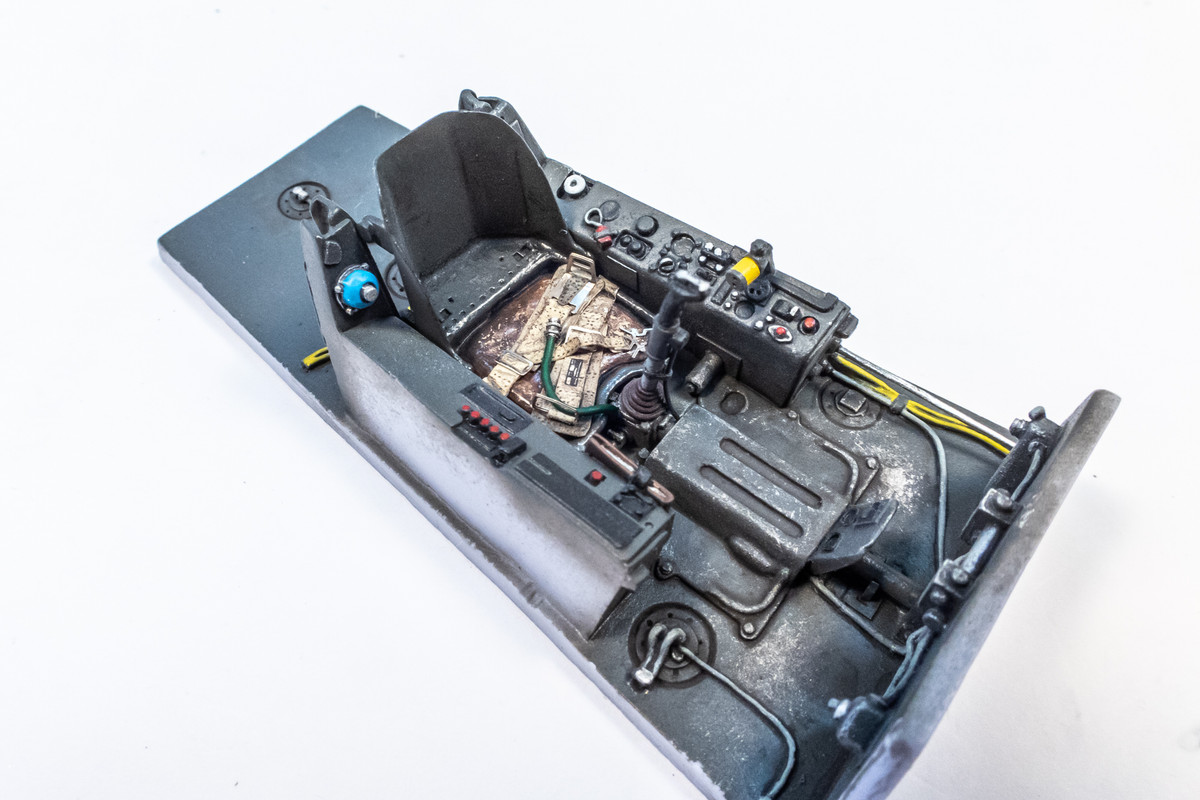

I can now start assembling the cockpit. The seat and control stick are glued into place using CA glue. I've added an oxygen tube per the directions on the Eagle Editions cockpit.
The sidewalls and rear cockpit sill are next to be glued into place, again using CA glue.
The foot pedals are glued into the roof, which is left completely unpainted because it will not be visible at all.
The roof holding the foot pedals cap off the cockpit tub. Remember all of the careful painting including the bright yellow electrical wiring? Most of it disappears after the boxing in of the cockpit.

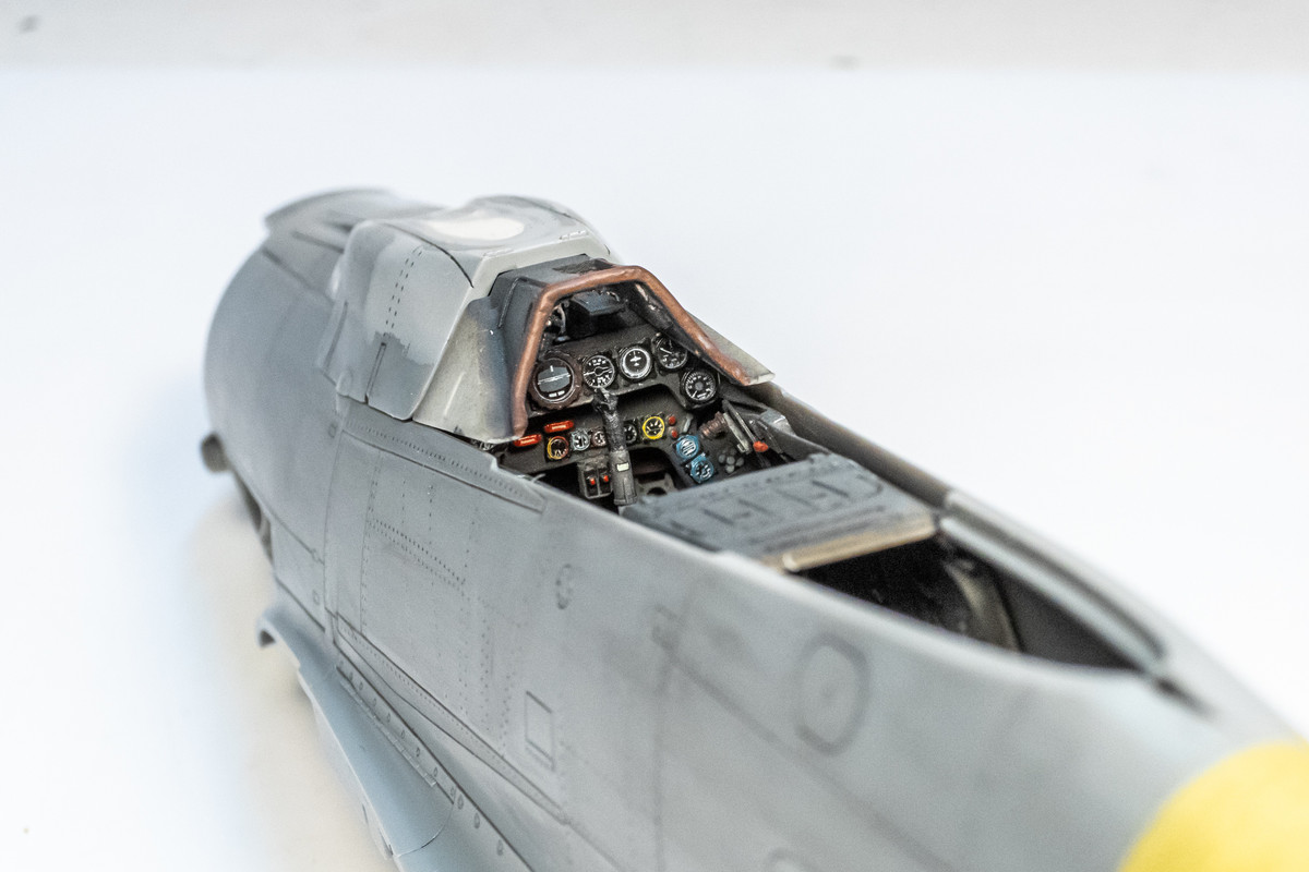

The main instrument panel is glued into the front cockpit hood, along with the shelf for the Revi 16B gun sight.
The cockpit stage is complete and we can verify the fit of the resin cockpit into the fuselage sides.

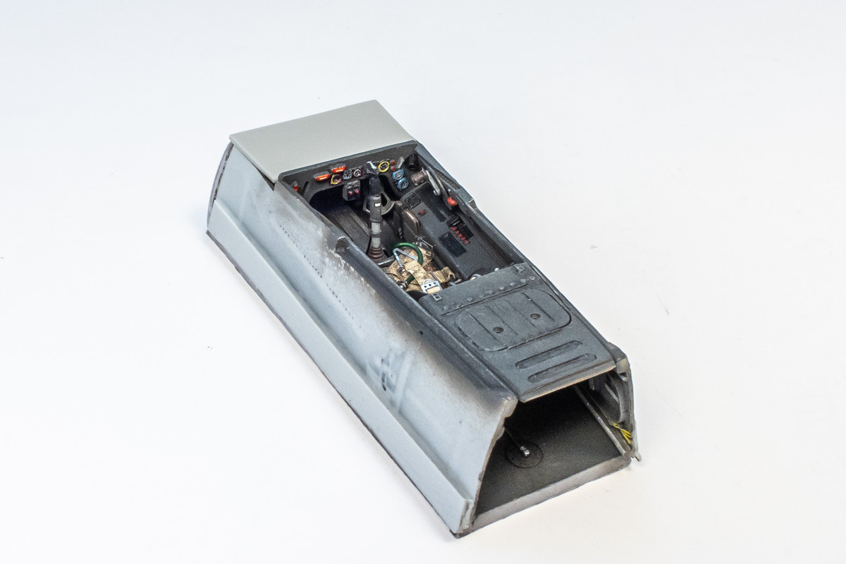

Verifying that the completed resin cockpit fits into the fuselage without issues.

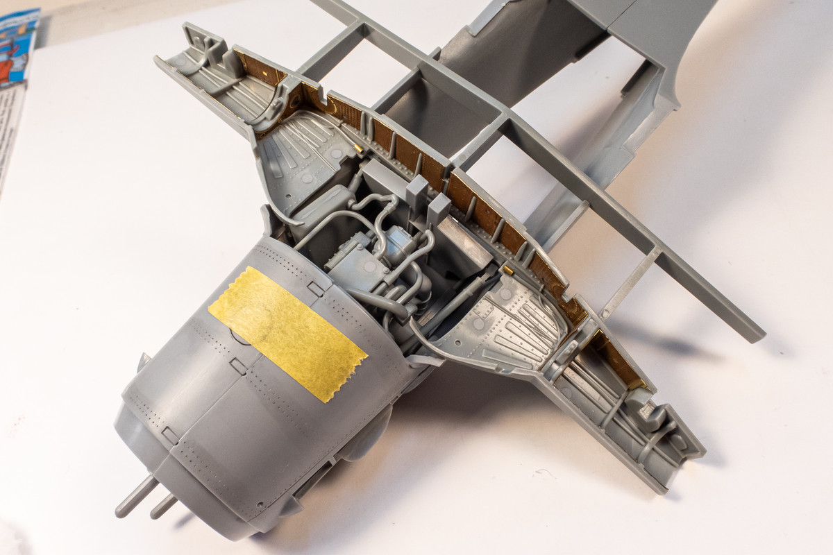

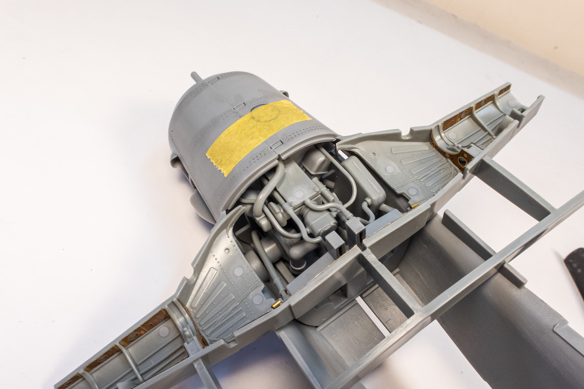

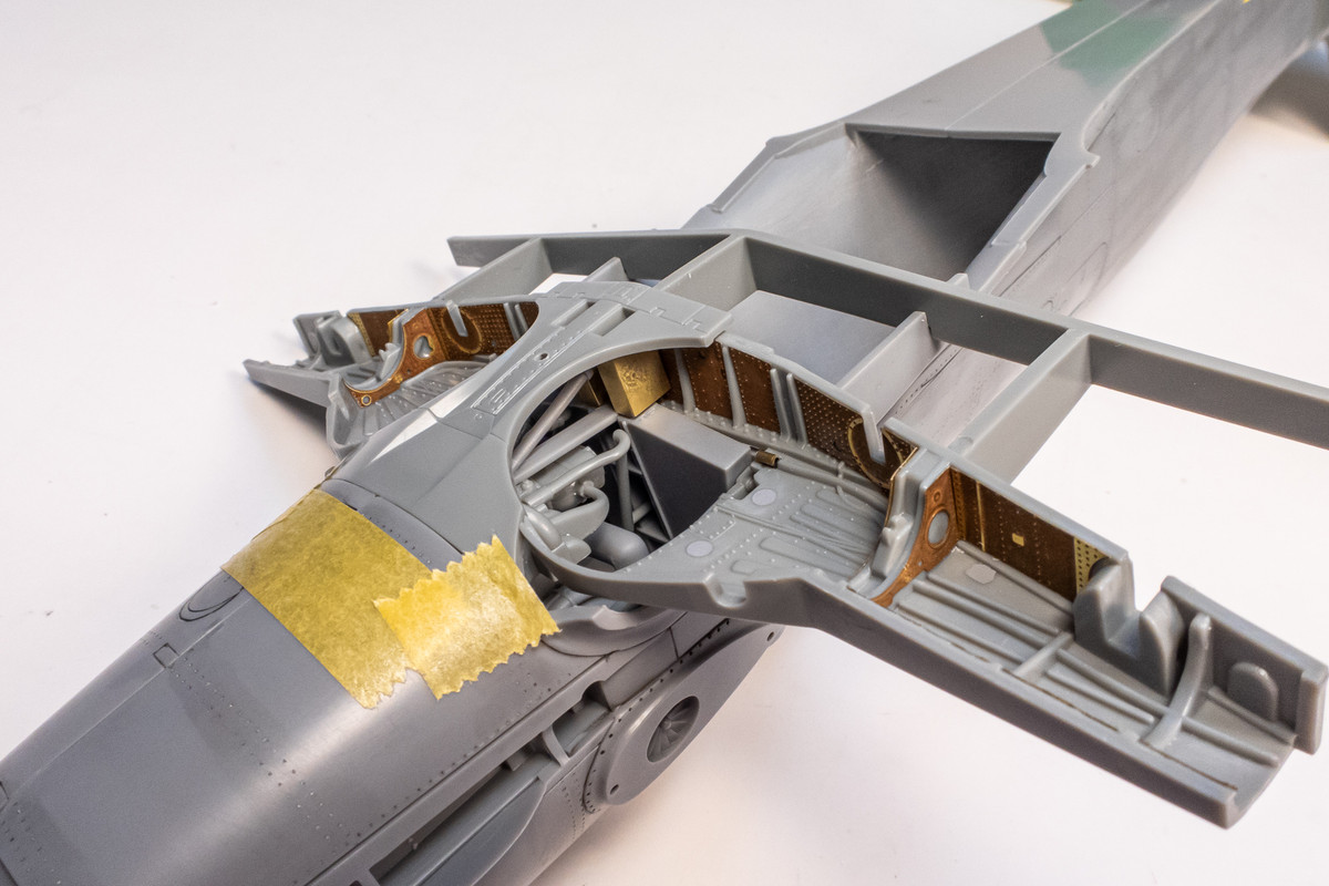

There are three things that get installed within the fuselage: the cockpit, the rear of the engine and the tail wheel. The cockpit is done so I'll be moving to the engine.

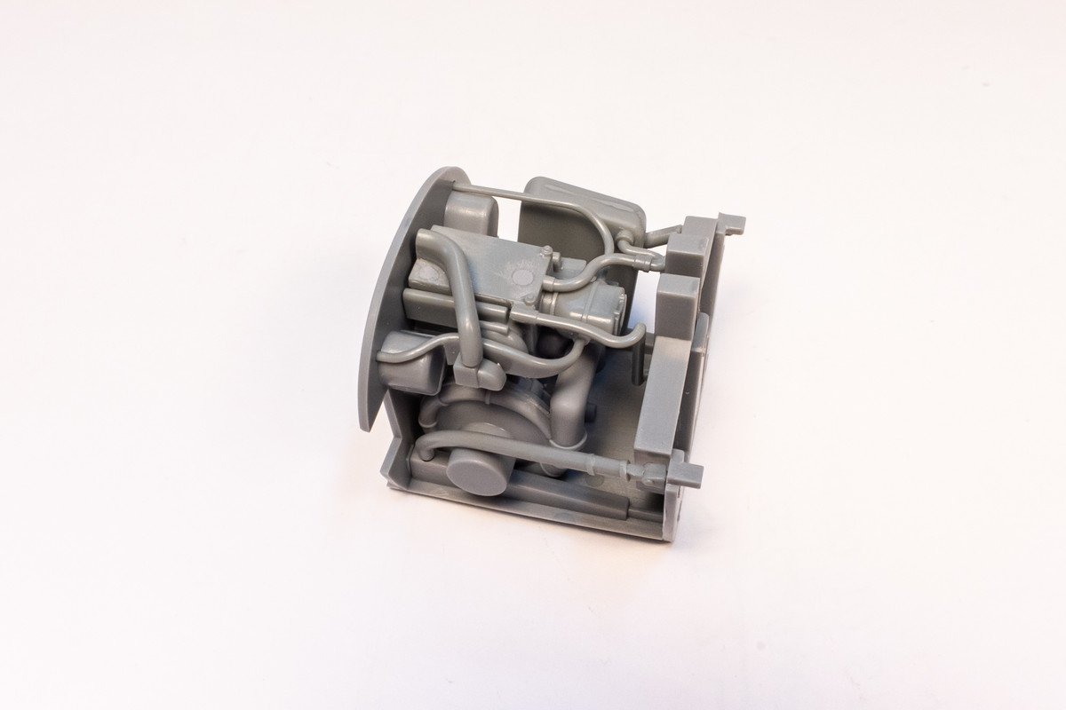

Unlike the Fw190A, the Dora had an open wheel well that allowed part of the Jumo 213 engine to be visible. Hasegawa provides a partial representation of the engine.
Assembled, it provides a reasonable representation of the bottom rear of the engine including some ducts and also the ammo cannisters for the MG131 cannon mounted above the engine.
I am going to add some more wiring in this area. Not going for accuracy here but I want to make it more believably busy, if that makes sense.

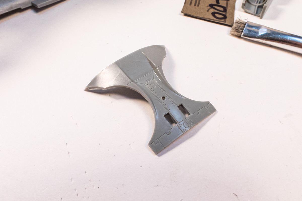

Notice that the chutes coming out of the ammo cannisters have solid ends. The Eduard exterior set that I have includes brass replacements for the chutes.
In order to make use of these hollow chutes, the openings on the bottom of the wings need to be opened up first.
The plastic chutes are cut off and the replacement brass chutes are glued into the interior side of the wing bottom piece.
Before the next round of dry-fitting, I glued the backings for the exhausts into place.
Here is what the engine area looks like with the brass ammo chutes added.
