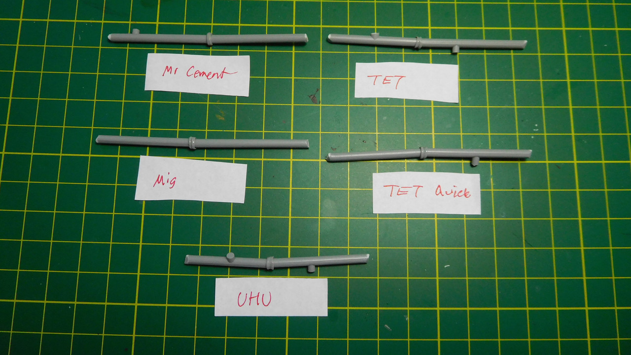

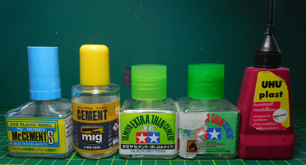

I regulary use 5 different cements.
- Mr.Cement S
- Tamiya Extra Thin Qucik Setting
- Ammo by Mig
- Tamiya Extra Thin
- UHU Plast
I wanted to see, with a very simple test, which cement makes the strongest bond...

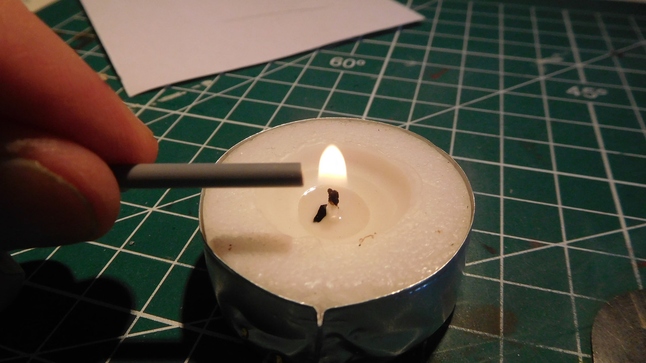

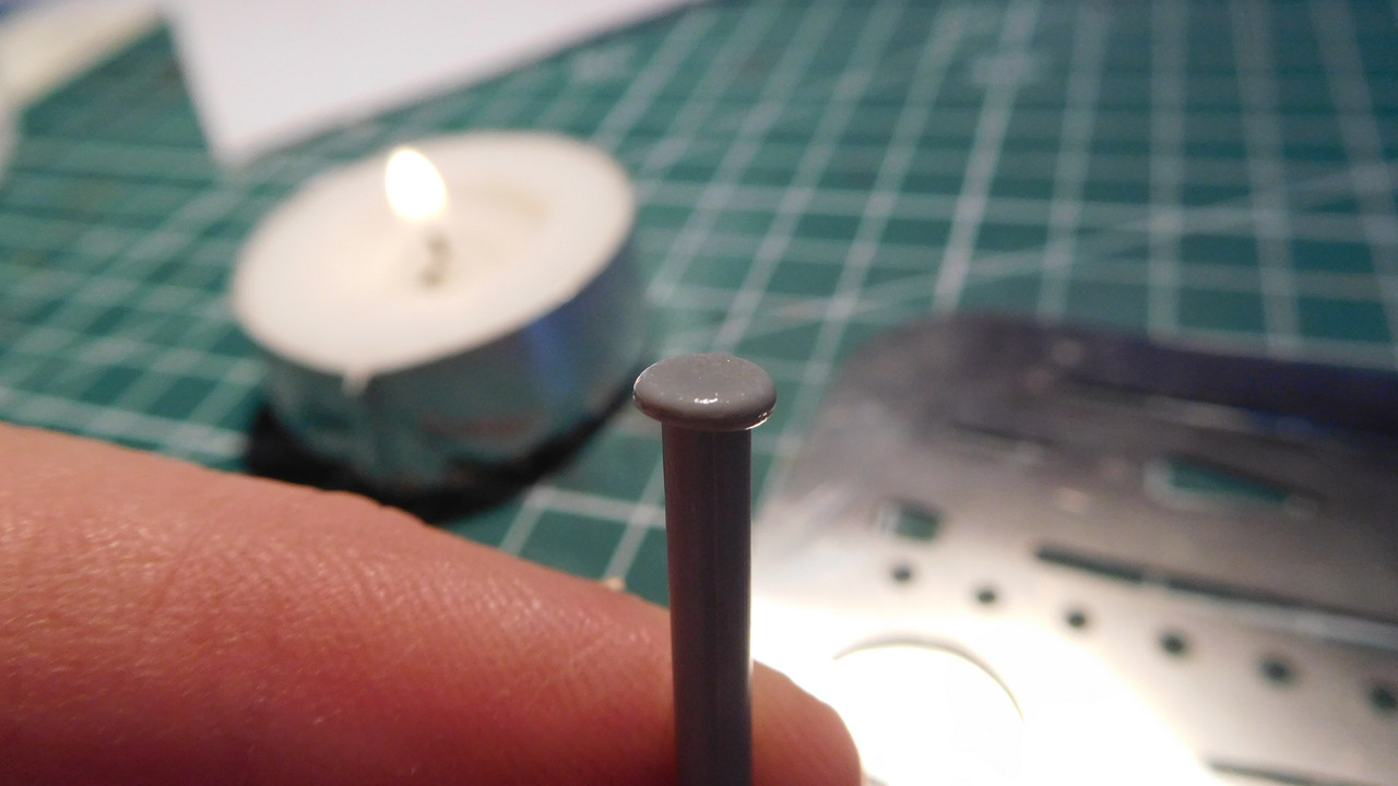

So I took a number of sprue pieces, heated the end of them, flattened them and finally glued them together, adding "enough" of cement on the bond.
After glueing them together, I let them dry / settle in 6 hrs time
And then, the "stress-test" begun...

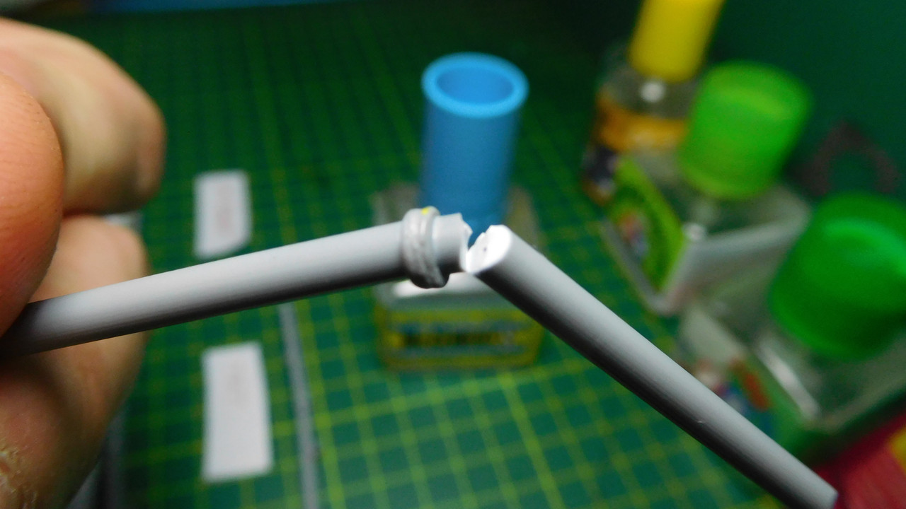

I just simply started to bend the sprue pieces until something would happen.
The result (drums)
The only cement, that succeeded to keep the bond unbrekable, was Mr.Cement S !
The sprue cracked but the bond was strong enough to survive the forces..
All other cements failed, the bond was not strong enough...

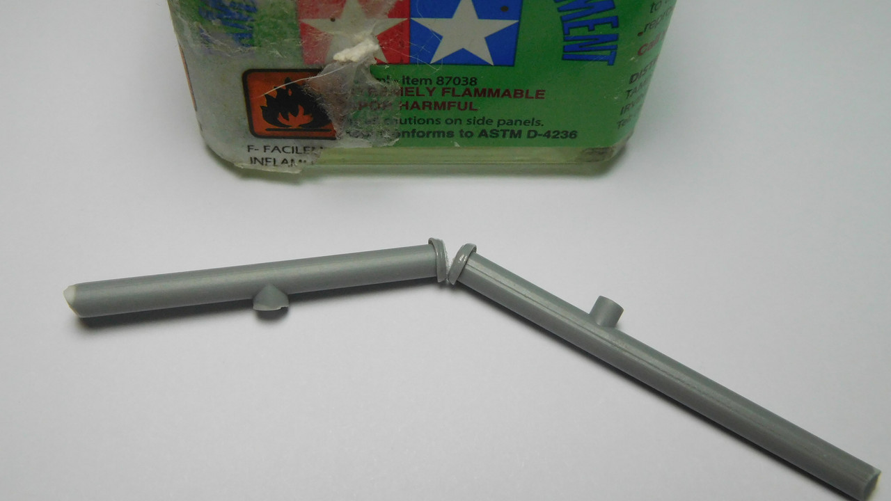

Nr 2 was Tamiyas (regular) Extra Thin. Here the bond did not "snap" off, but was sort of slowly separated.

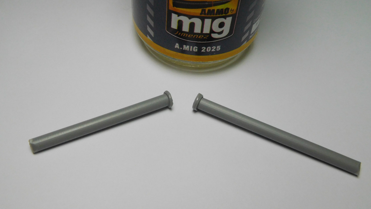

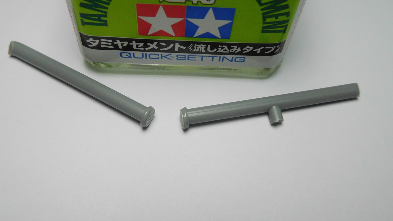

Third and forth place was shared between Tamiyas Extra Thin Quick setting and Ammo by Migs cements. The bond just "snapped" and broke

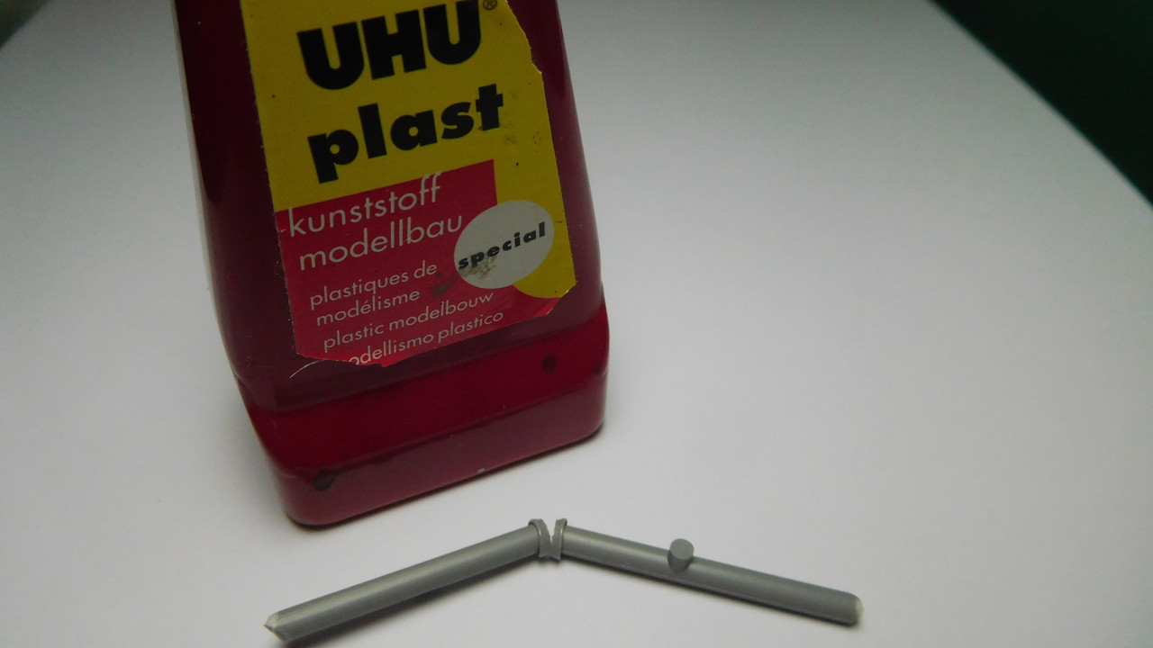

5th and last place goes to UHU Plastic glue. The bond was weakest and the pieces came off pretty shortly after the bending process started..
Will I now change my view on my "favorite" cements ? Probably not, eventually they are all good cements, they have their advantages all and that comes to either how quickly they settle (Tamiyas Quick setting) or how slowly they settle (UHU) or how the brush works best in different type of builds (Ammos and Mr. Cement having the best brushes).
What I just wanted to compare, how strong the bond is.
Now I know
