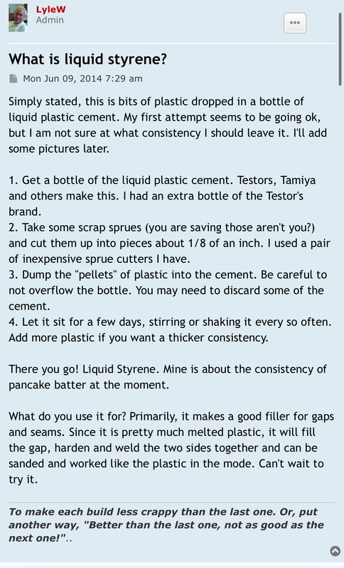

I started making a fresh batch last night using some sprue from the 1961 Revell kit. This way I’ll be able to match in the plastic precisely. I already had a bit of an issue where I will use the sludge as a filler. If it’s still here on the forum it was Kari who turned me onto doing this and he posted a great how to make it. I’ll look for the link.

It was Lyle!!!

Hmmm… I’ll have to try it. How long does liquid sprue last once mixed?

BlackSheep214 wrote: ↑Wed Dec 18, 2024 3:20 pm Hmmm… I’ll have to try it. How long does liquid sprue last once mixed?
I used a nearly empty Tamiya Extra Thin bottle and throwed some pieces of sprue in it. After a few hours of chemical (re)action and a brief stir it's ready to go. If you keep the lid tight it should be good for at least half a year. You can reactivate or thin it down to your needs by adding some TET or simply methyl ethyl ketone (aka butanone).
