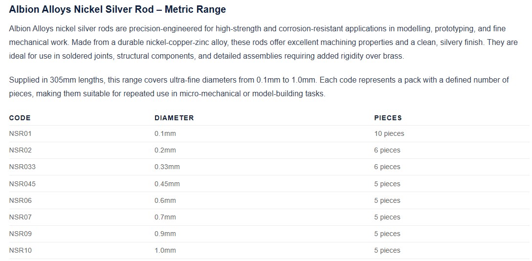

Chris, I'm going to use Albion Alloys Nickel Silver rod on a 1/72 Stearman, the classic old time kit given the deluxe treatment. Albion Alloys sells this in 0.1, 0.2, 0.33, 0.45 and more. I'm not going to be at home for a week, so I can't tell you what size I chose for the job but if it's of interest, let me know. My solutions tend to be nonstandard, though. Oooshi Von Rooster is a great source for thread, but I swear monofilament gets the job done just as well as his high-priced versions.

speedgraflex wrote: Sun Sep 13, 2026 8:08 pm Chris, I'm going to use Albion Alloys Nickel Silver rod on a 1/72 Stearman, the classic old time kit given the deluxe treatment. Albion Alloys sells this in 0.1, 0.2, 0.33, 0.45 and more. I'm not going to be at home for a week, so I can't tell you what size I chose for the job but if it's of interest, let me know. My solutions tend to be nonstandard, though. Oooshi Von Rooster is a great source for thread, but I swear monofilament gets the job done just as well as his high-priced versions.
Bruce are those measurements in metric or imperial? There is going to be quite a difference between 0.1 mm and 0.1”
They are metric, I was not aware of that AA makes such thin rods... :hmm:
