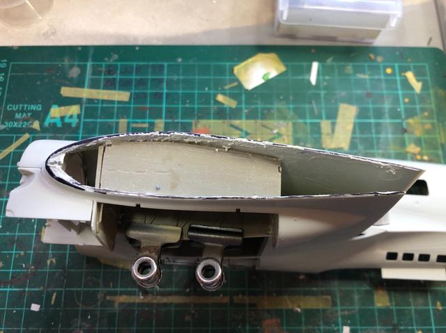

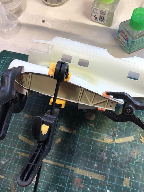

Well it’s in. The old adage about a plan not working after the first shot is true. After fiddling for two hours with my planned install, I went with the front first then the roof and rear pieces put together and shuffled into place. The sides were then put in but it cost me some details and some alignment issues. This was mainly caused by not having the forward piece at as close to 90 degrees as you can. If it is out it will throw it all out. Styrene strips and card will fix the errors with some putty. If I ever build another, I shall ignore the instructions and put the MLG in place before joining the wings:

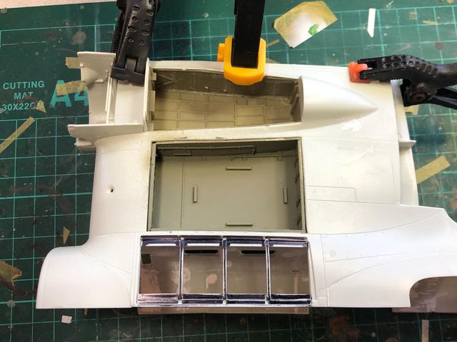

Incremental progress but progress nonetheless. I started cleaning up the interior surfaces:

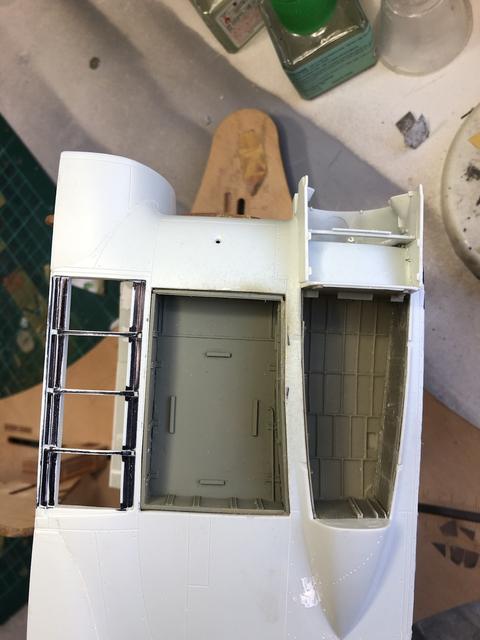

The MLG, fuel cell compartment and fuel cell fillers have all had a first coat of RLM02 and finally been installed:

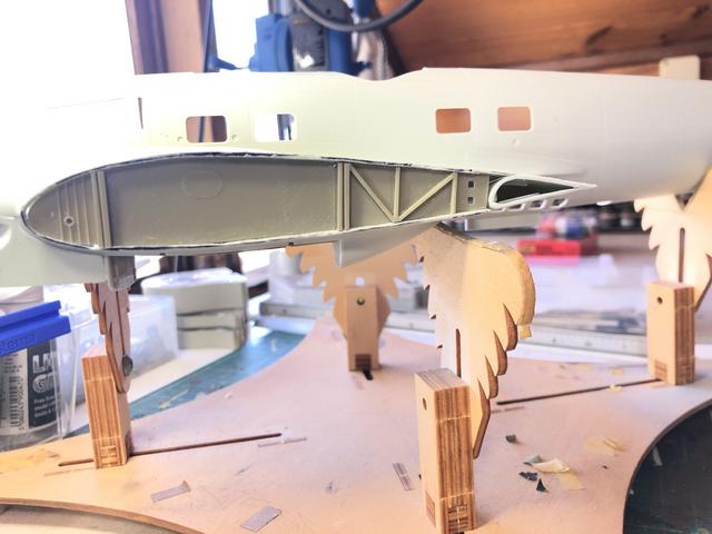

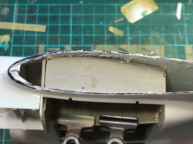

The wing cross section was removed with a Dremel cutting disc and tidied up before the resin piece was inserted into the opening. There is still a little clean up but I am happy thus far:
The inner flap was cemented in place and will have a small resin piece covering over the hole:

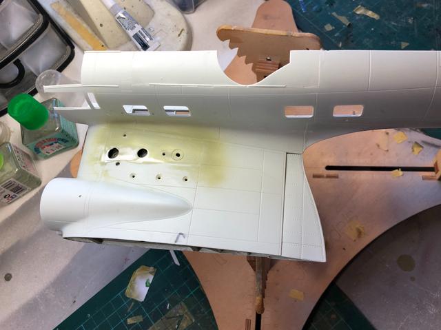

The fix to the upper wing was installed some time ago. I wanted to address the forward opening but it didn’t go quite to plan and will require revisiting. I have a plan to line it with thin styrene strip around the opening and fill the outer edges. It may be extreme AMS but I would like to get it right as it is such an obvious aspect:

So mich going on in this build, it all looks great. The fix for the upper wing looks like it blended in perfectly.

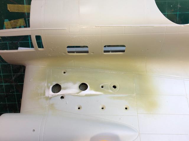

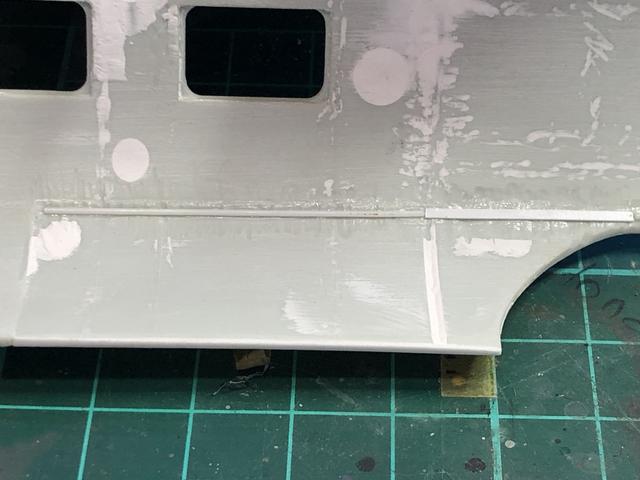

I got a bit vigorous in cleaning up the join between the fuselage and the upper gun opening. It is a very thin join and prone to breaking. I reinforced it with some 0.5mm rod and sheet:
These will be sanded flush when the rest of the interior is done.

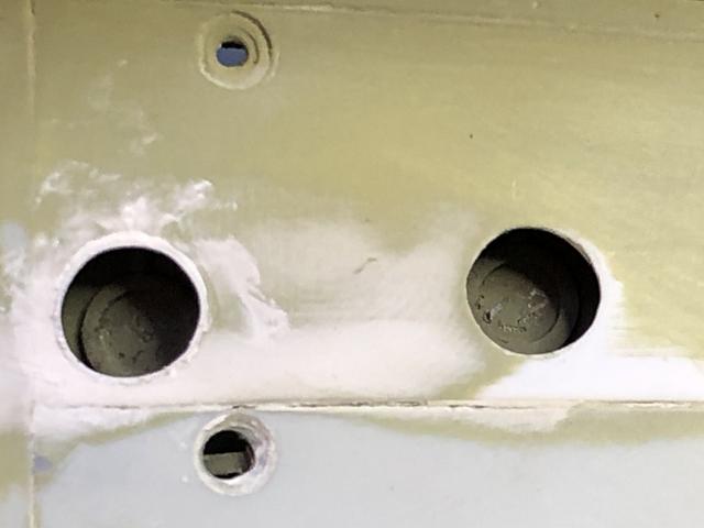

I formed some 0.5mm X 1mm styrene sheet around the 6mm ish rod and then inserted into the irregular hole of the forward fuel filler opening. I think I may have cracked this at last!
