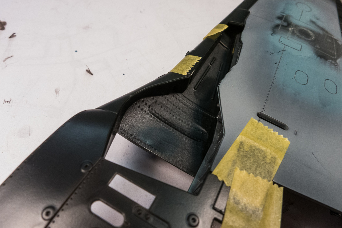

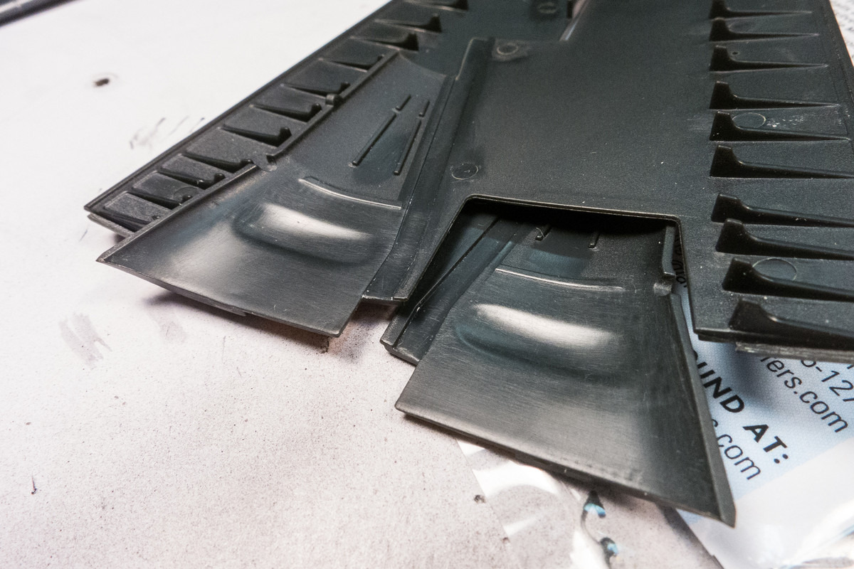

I was able to do a little bit of work on the Ta152H. While playing around with the wings, I noticed the ceiling of the wheel wells featured this rivet detail.
The detail is soft and vague so I thought I'd give this product a shot...
They are applied like decals but instead of flat markings, they are tiny resin bumps. First, the raised detail in the wheel wells is removed.
The Archer's rivets are applied in custom cut strips. I used Microsol to bond the thin carrier film to the plastic.

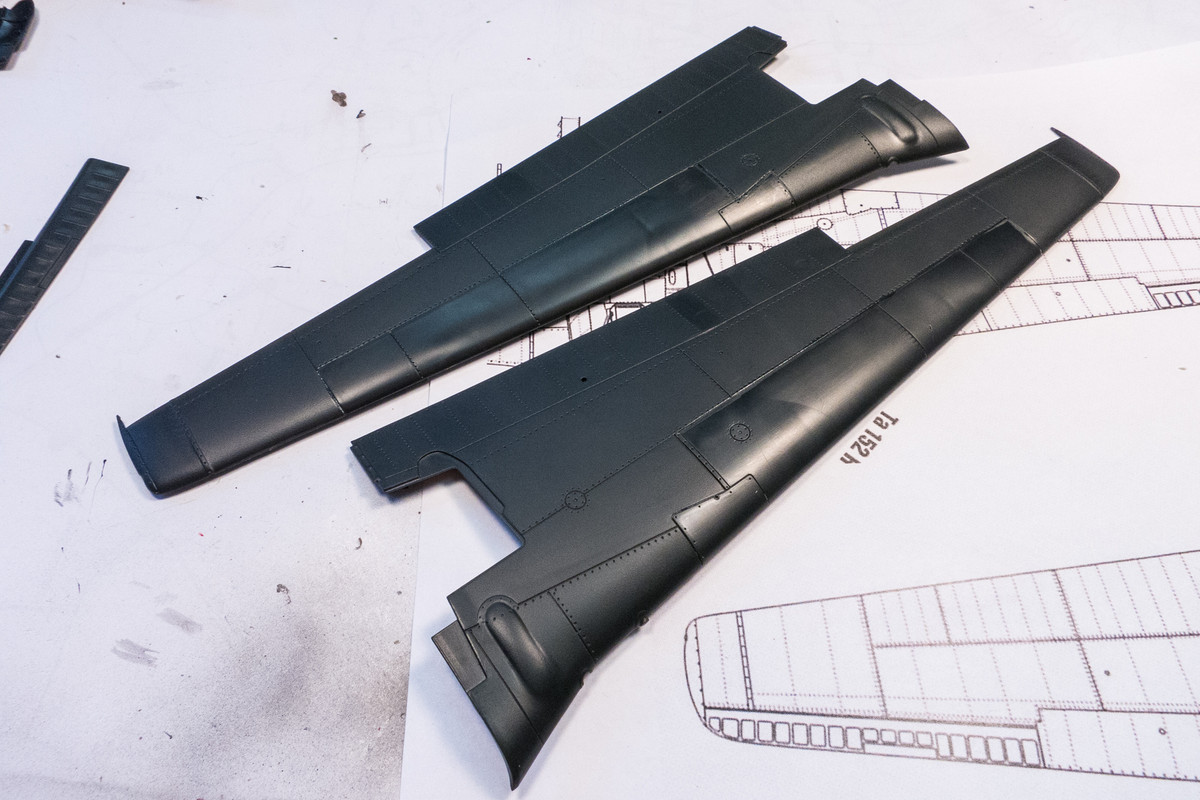

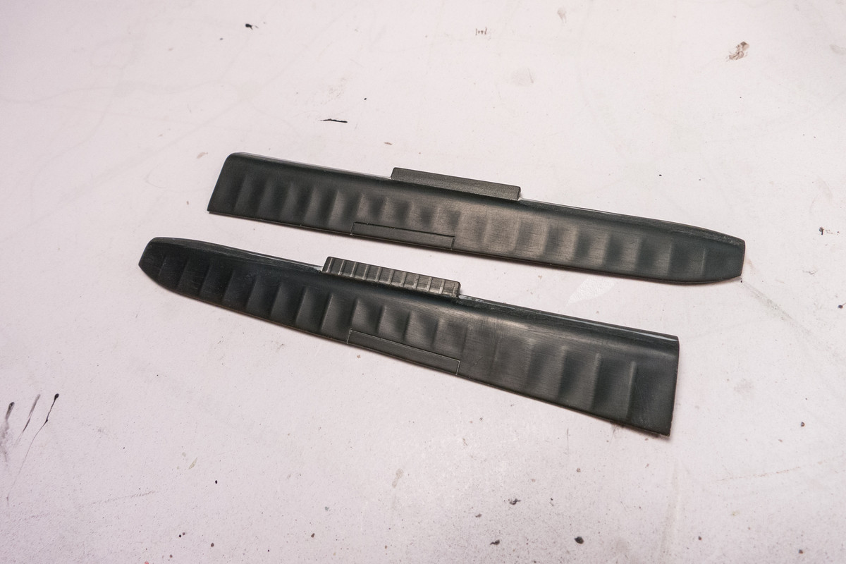

The ailerons have the opposite problem. Raised detail that's a little too defined and sharp.
I've toned down the ribs by sanding.

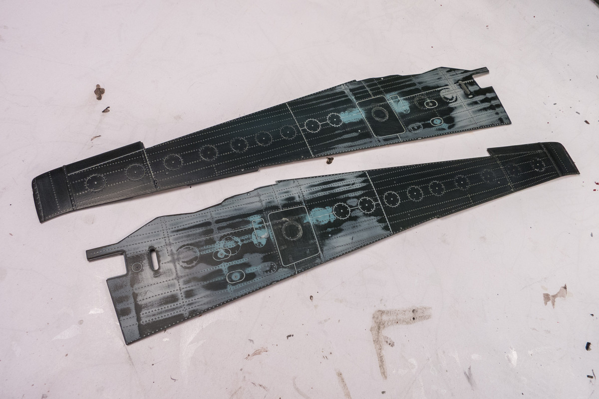

I've glued the frontal insert piece into the wing uppers so that I can address the seams and riveting before glued the wing halves together.
Finally, I've completed the riveting on the wing bottoms.

I'm running into the problem of having all of the sanding dust plugging up my rivet holes. I'll probably have to run the rivet tool over much of the aircraft during the painting stage. Whatta pain!

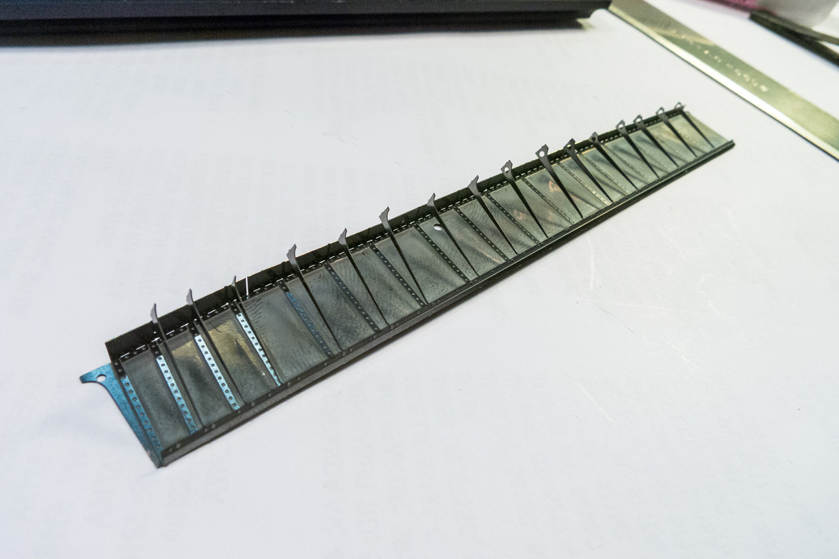

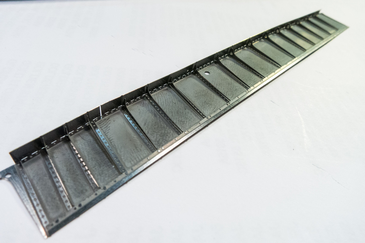

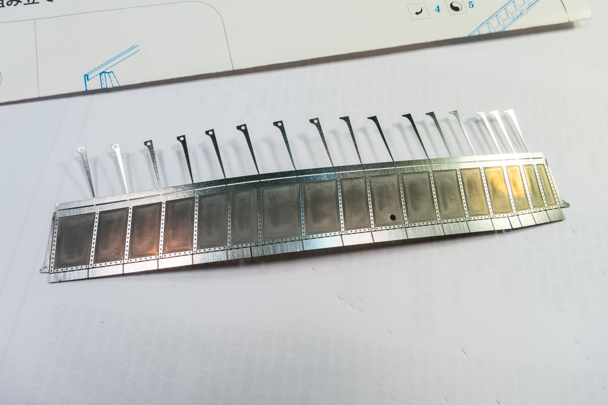

Thanks guys! From rivets to brass... first attempt at tackling the photoetch flaps.
This set is sold by Zoukei-Mura but is obviously an Eduard product. No English on the instructions but we shouldn't need them right?
Gonna start with the upper flaps because these look much simpler to fold than the lower, movable flaps.
I used the Small Shop hold and fold to fold up the two end wall sections.
I then folded the middle section up "manually" using tweezers.
The end with the delicately attached spars is then folded up 90 degrees.
Before folding this section completely down, the spars are carefully rotated 90 degrees so that they are perpendicular to the flap surfaces.
When folded down completely, the spars can now be secured into place with glue. Looks good right?
I wish it stayed that way. After securing the majority of the spars down by running thin CA glue along the joints. I went back and used debonder to clean up the glue residue from the spars that didn't get secured properly. The debonder seems to work not just on contact but on proximity to fumes and seemed to weaken the bonds of the other spars because they kept popping up. Glue one down... another one would pop up. It turned into an arcade game session...
After re-gluing all of the spars down at least once and breaking two off in the process, half of them are still not glued down. Maybe my batch of CA glue has gone bad? Before I did something I would regret, I pushed myself away from the work station and called it a night.
