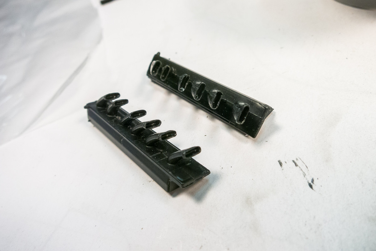

The dimples on the exhaust pipes were also gouged out further to simulate hollowness. The black kit plastic is interesting... a bit soft and rubbery like hard vinyl. It has some advantages like being flexible and less prone to breakage but it's more difficult to sand smooth. The insides of the exhausts were touched up with Tamiya Extra Thin cement to get rid of the bits of excess plastic left over from the gouging process.
