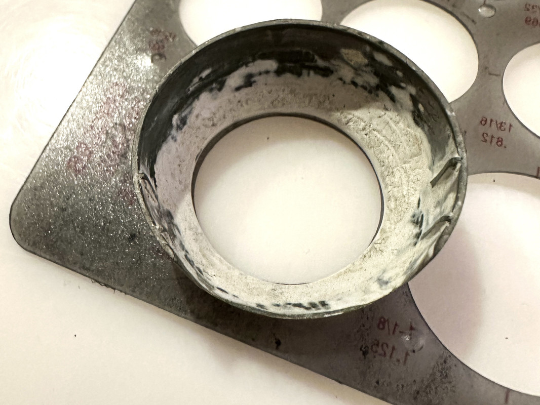

You are far too kind but I gobble up your kindness eagerly! Your words are greatly appreciated. I promised I wasn’t gonna use filler but that cowling is messed up and doesn’t align properly. It’s certainly one of those deal breakers for a model of a Sopwith Camel—one of its distinguishing features—so I have extended my putty around the entire inner opening front and back with hope, a great deal of hope, that I may be able to properly replicate what I see when I see a Sopwith Camel’s cowling. Anyway I sincerely hope I get there in the end.

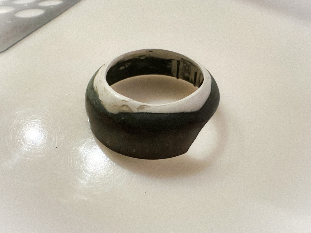

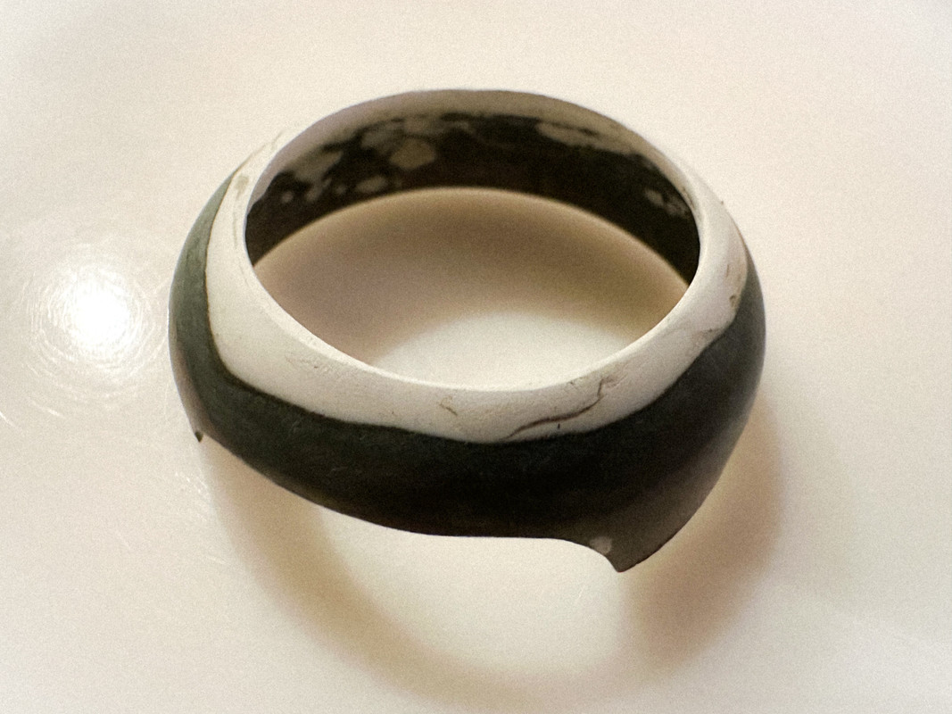

Forming a 1” diameter inner circle by hand—first the Milliput is mixed then it is rolled into a thin tube.
Pressing from the inside to form a circle.
The excess is hand rolled off against the exterior surface.
Then—sanded.
And—sanded again.
Starts to look really perfect Bruce!

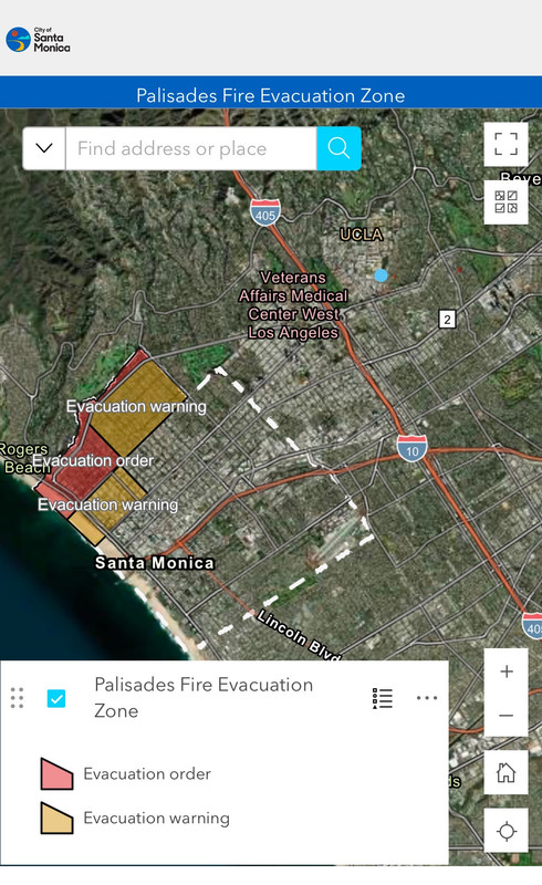

I am the blue dot near UCLA.
I had to rearrange my schedule due to the massive wildfires that are burning in both the valley (Altadena, Pasadena) where the studio facilities are located and the Palisades Fire. Not a good time here—zero containment for both fires.
