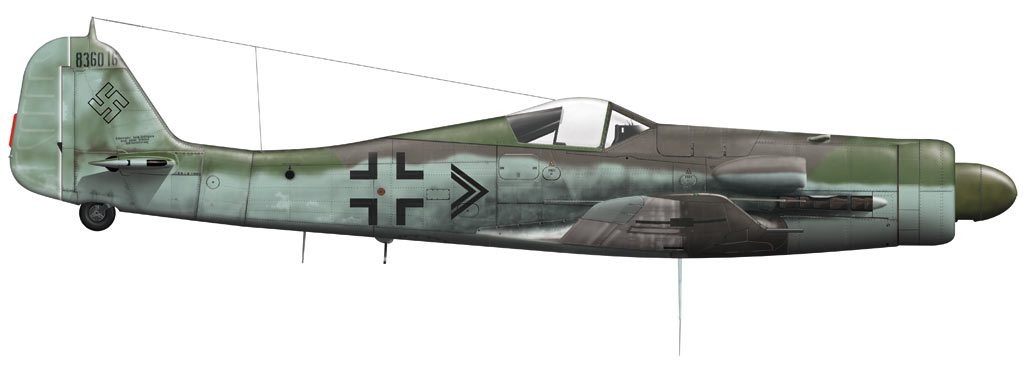

My plan, as of now, is to paint the upper wings RLM 74/75 with the 74 wrapping under to the forward wing bottoms. The base color for the fuselage will 76/81/82, similar to this color profile of 836016, one of the other recorded D-13's...
I understand that the above profile is purely speculative since the only photo of 836016 is black and white and only shows the aircraft from the double chevron marking back. My placement of the 81/82 will be different as I want the lighter 82 around the canopy/windscreen/cowling as I agree with Crandall's assertion that the mottle pattern on the area in front of the windscreen is dark on light rather than light on dark as proposed by JaPo. After the base camo is established, a random mottle pattern using 82/83 will be placed over all of the upper surfaces.

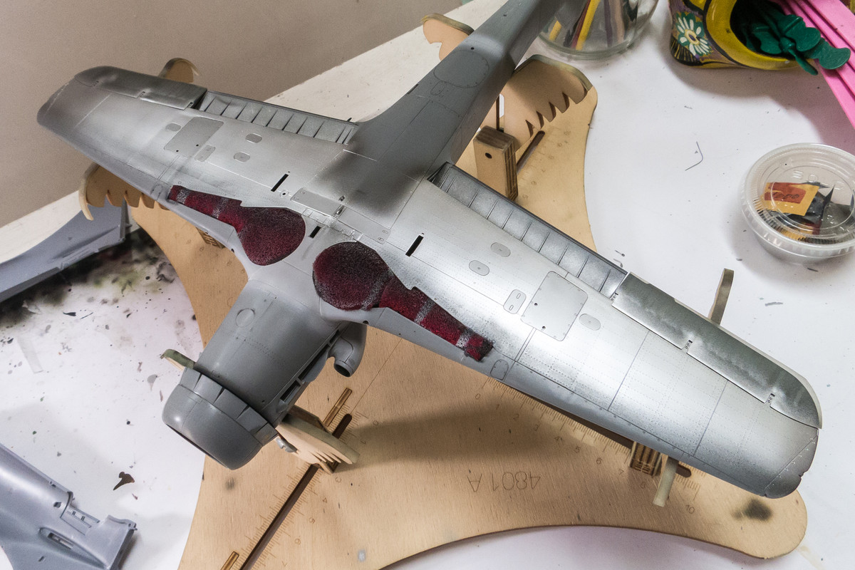

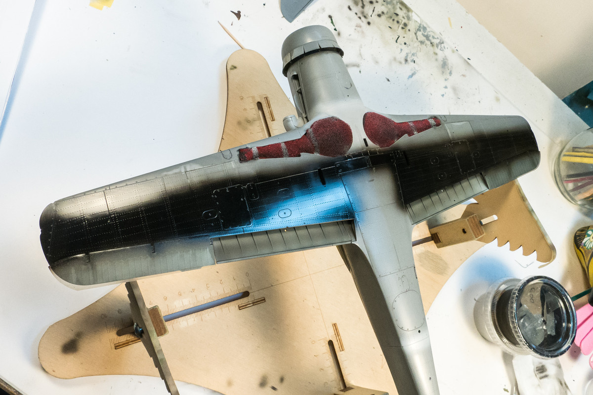

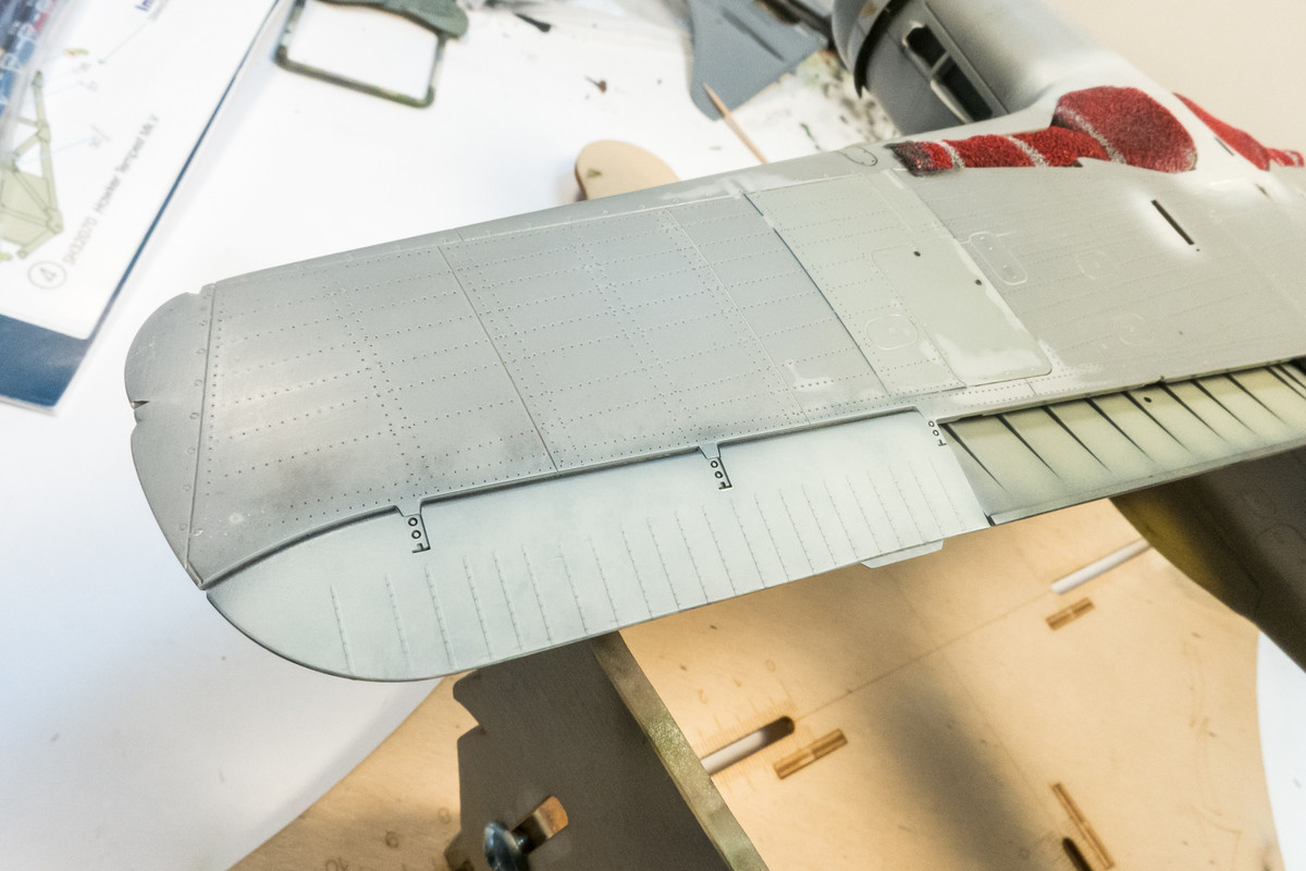

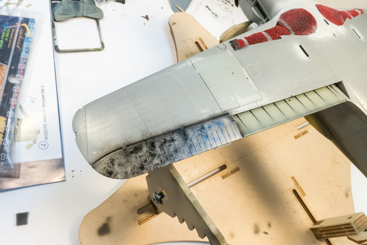

First steps in the painting process... the ailerons were given a black mottle pre-shade and then sprayed with Mr Hobby Aqueous RLM76. The pre-shading on such a small area is really not going to be noticeable but I wanted to maintain consistency in my work flow. Note the red-colored masks in the wheel wells. I have previously used these pieces of foam when I built my JV44 Dora.

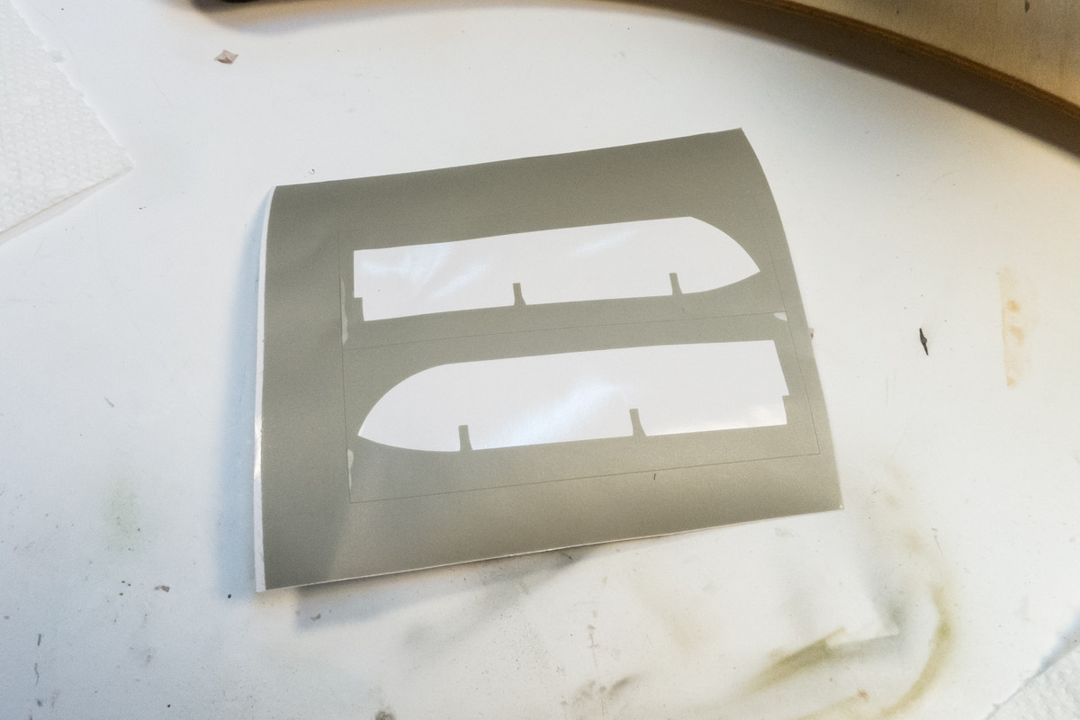

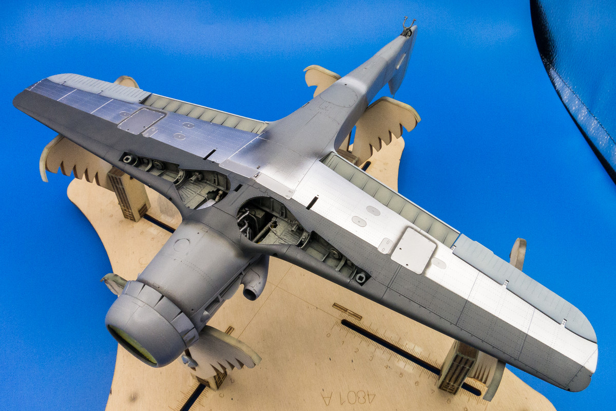

After the ailerons were masked off using custom cut masks from the Silhouette Portrait, a coat of Tamiya Black was laid down as a base for the metal finish.
The primary metal color was AK Extreme Metal Aluminum, which is very similar to Alclad. Again, using a custom cut mask for the small panels and ports, a contrast was introduced using Alclad Dark Aluminum.

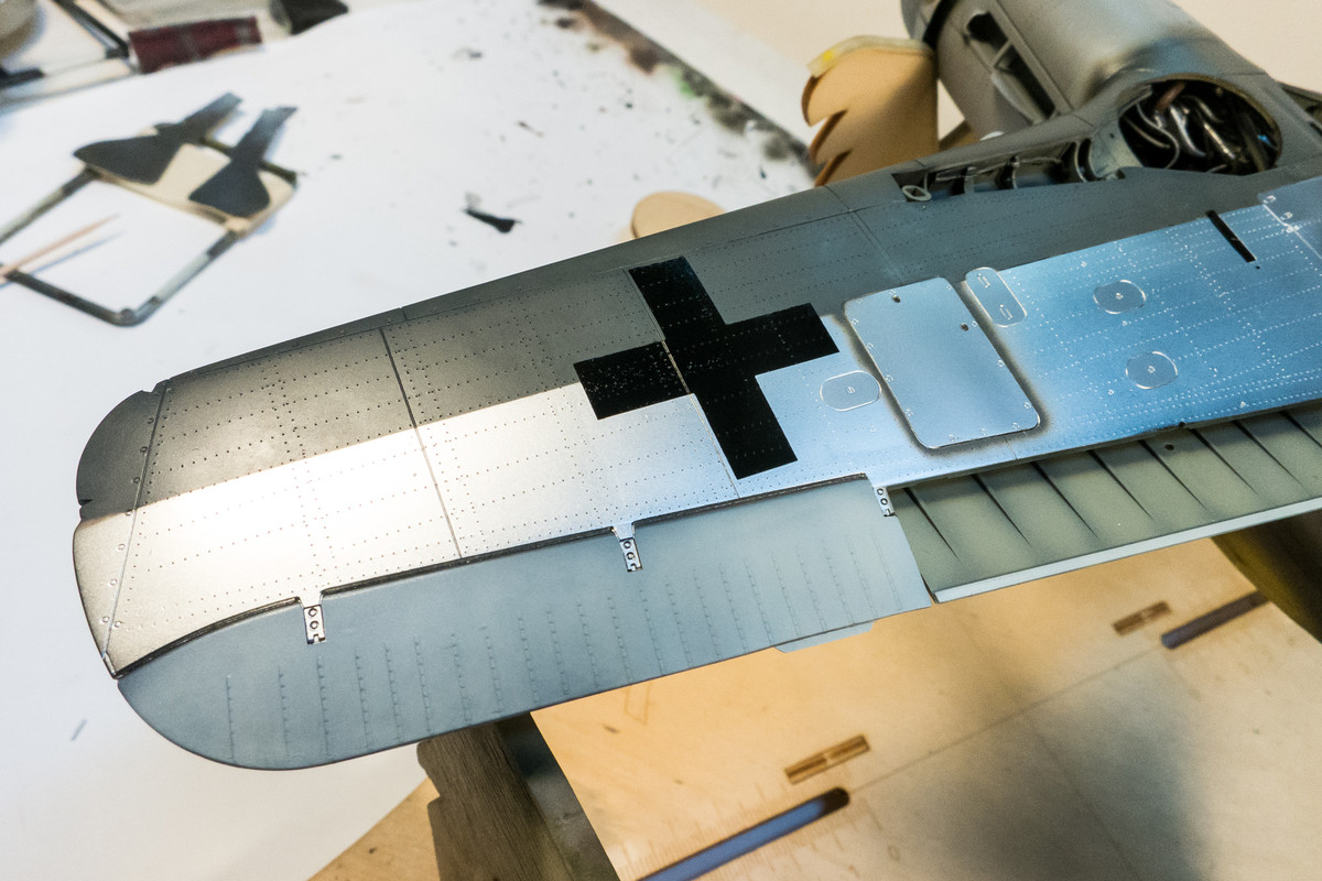

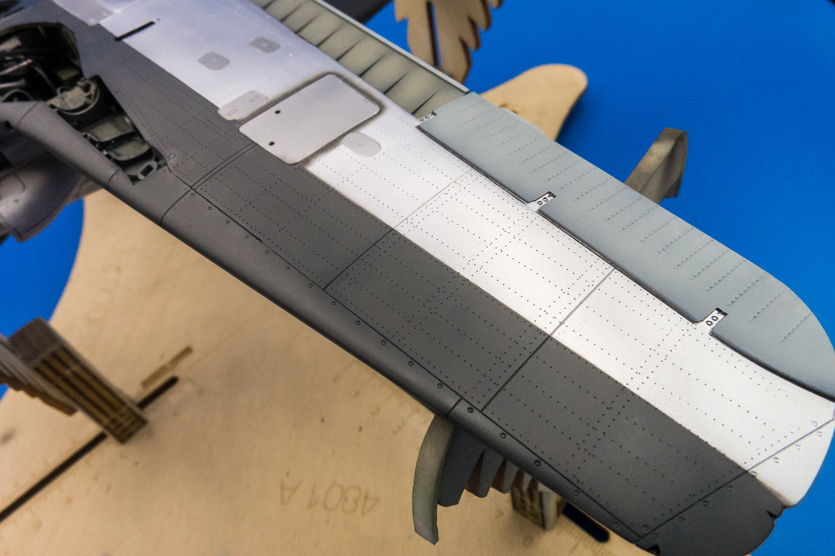

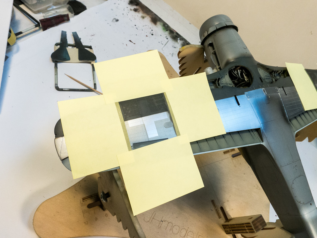

The forward portion of the wing bottoms were masked off using Post-its to prevent damage to the aluminum color and sprayed with Mr Hobby Aqueous RLM 74.
I should've done my normal pre-shading all at one time instead of doing the bottom-only first. Now I'll have to do some masking work before I can continue.

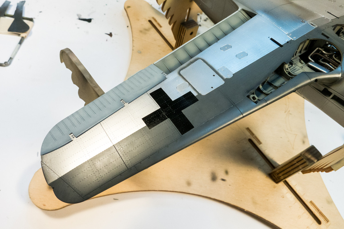

Thanks guys! Neat but not perfect... you can see the overspray in the last pic, bottom right corner.

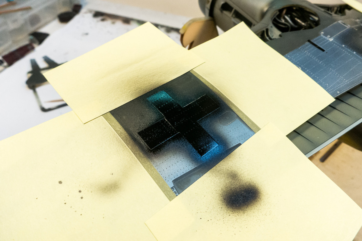

Since I've gone this far, I may as finish off the wing bottoms now. I painted the simplified black crosses on the bottom using masks. When cutting masks using the Silhouette Portrait or other craft cutter, it pays to inspect the masks very closely before using. Every once in a while I'll find a wobbly line or shape which will require re-cutting.
I'm going to mask the bottom areas and move to pre-shading the rest of the model.
