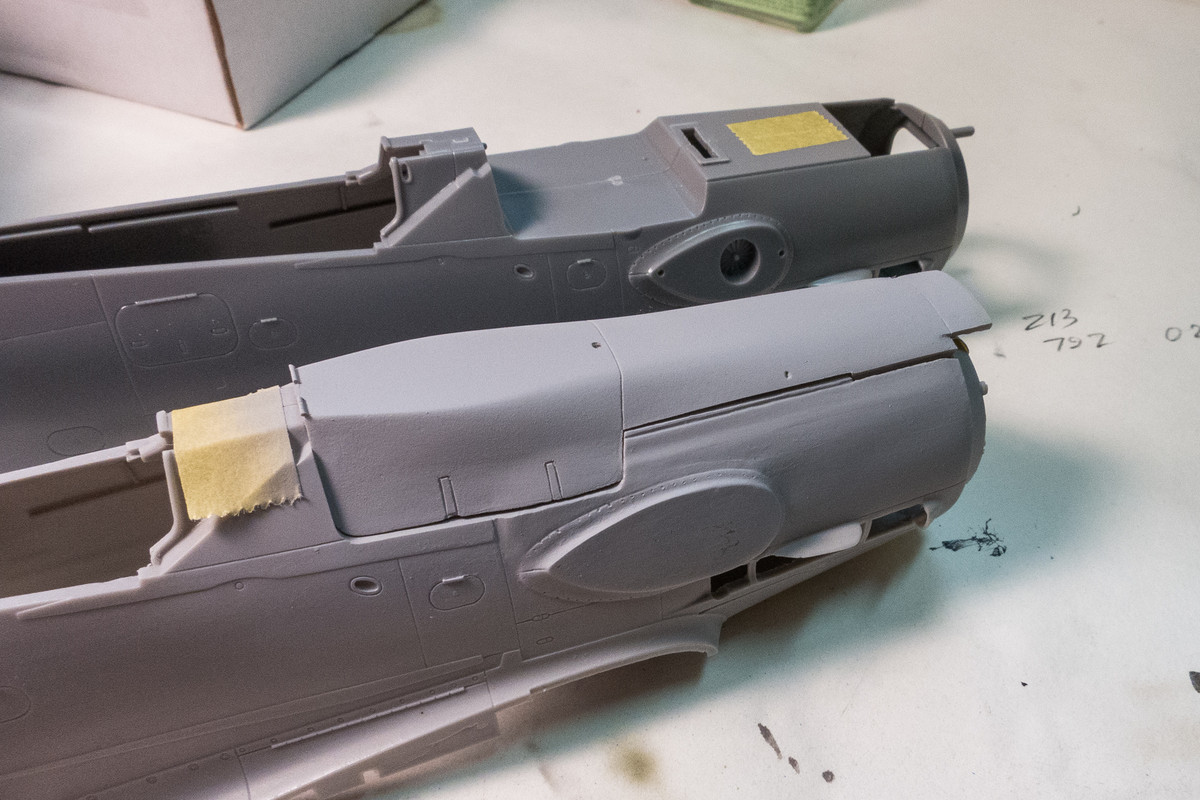

I sawed off the RM cowling from its casting block, cleaned it up and mounted it on the Hasegawa D-9 fuselage. It took some extra trimming on the cowling ends to get it to fit, length-wise. It appears that the bottom rear edge of the cowling is narrower than the fuselage, resulting in a noticeable step that would need to be corrected.
The GM cowling, although not perfect, fits better than the RM cowling. Dimensions seem to correspond more accurately to the Hasegawa fuselage and will require less remedial work.
The two D-13 supercharger intakes are slightly different in shape. The RM intake has a leaner look with a thinner lip around the intake opening. It also has some recessed panel line details missing from the GM intake and, maybe significantly, it includes the flare at the base. I am leaning on utilizing the RM intake as it would take less work to mount.

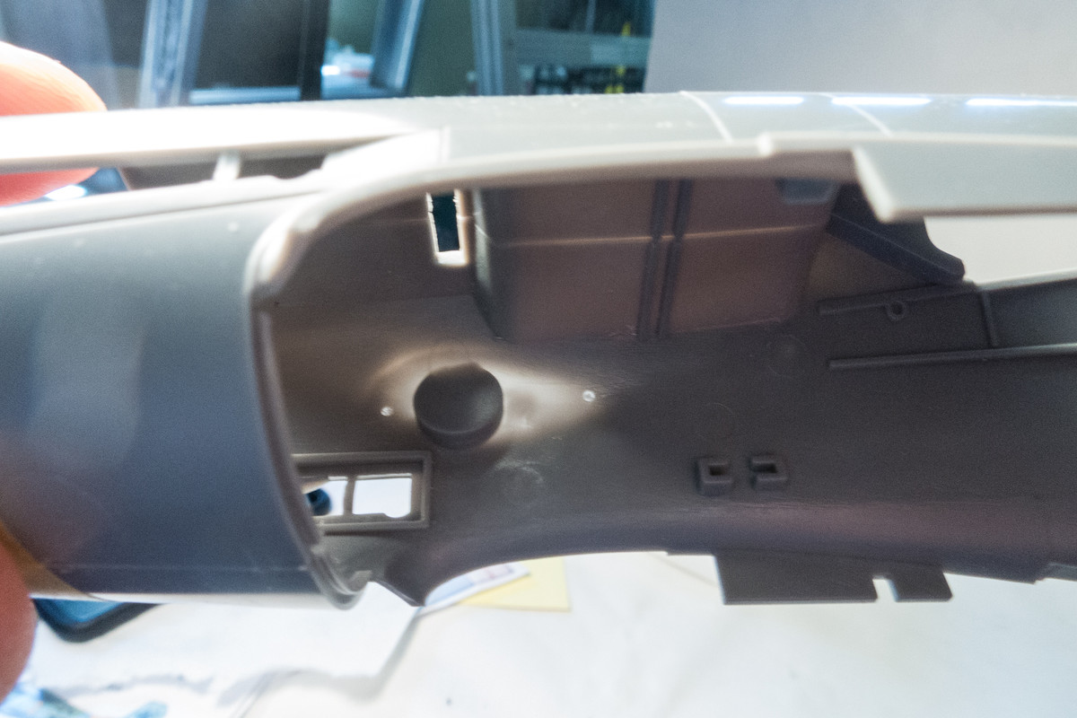

The big ugly task comes first. I have to get the supercharger intake off before the sculpting begins. And this is the most awkward type of removal there is for me.
I decided to attack it with a grinding stone mounted on the rotary tool. Nice and slow since the tool will melt plastic if kept in one place for very long.
Getting closer but still not quite there.
I noticed that I'm getting dangerously close to punching through to the other side.

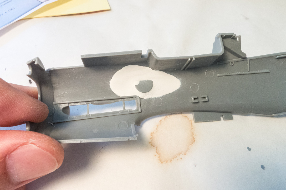

This might prolong the cutting down process but I decided that it was important that I establish a solid base for the upcoming sculpting work. So I backed the thin areas with White Milliput. Also filled in the fan opening on the exterior side.

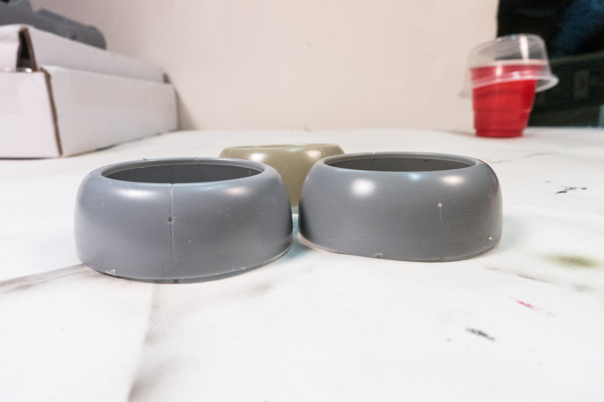

While I had the rotary tool out, I mounted the kit radiator cowling to it and re-shaped it. It's hard to see in the photos, but the kit cowling is too square and needs a more pronounced taper towards the front. The re-shaped on is on the right while the unmodified cowling is on the left. I used the Quickboost resin cowling, which I've previously found to be slightly undersized in diameter, as a reference.

Thanks Lyle!
Another view of the radiator cowling to try and show the re-shaping effort. Doesn't the kit part on the right look boxier?
