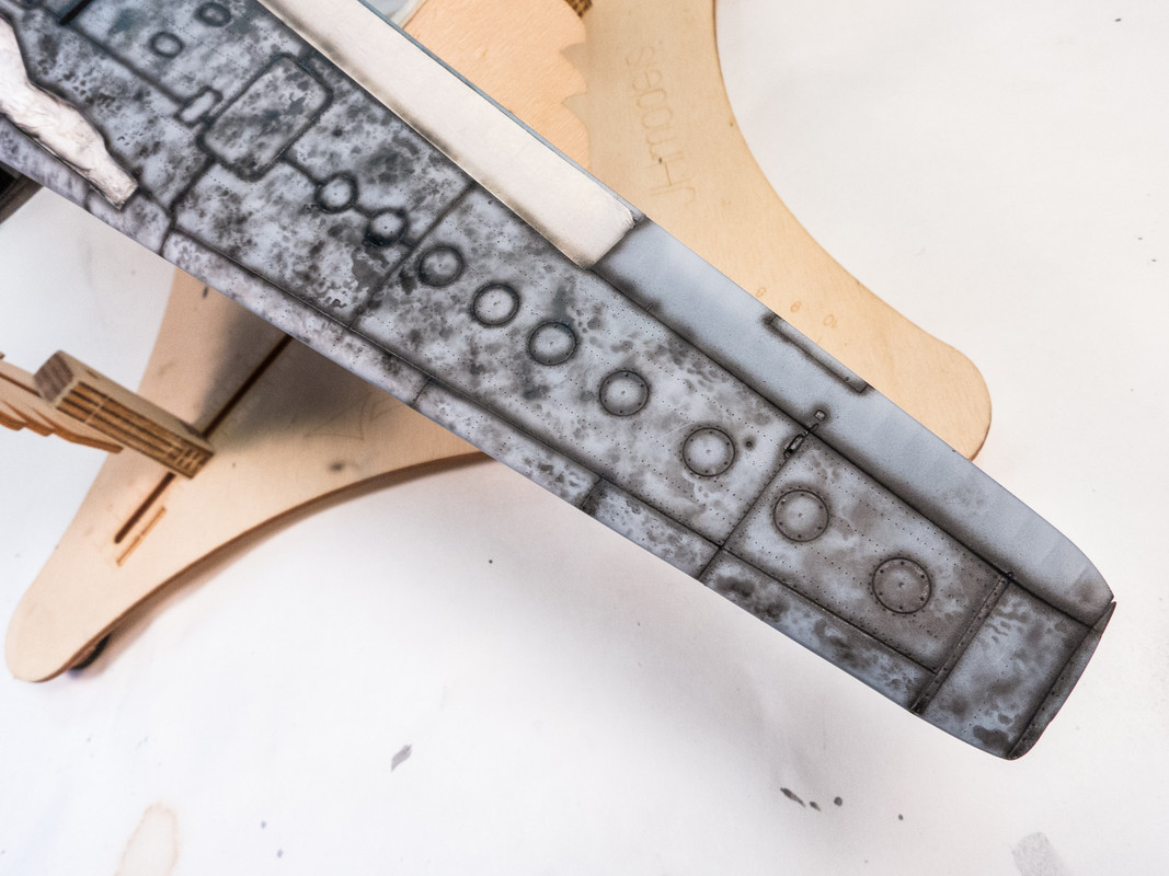

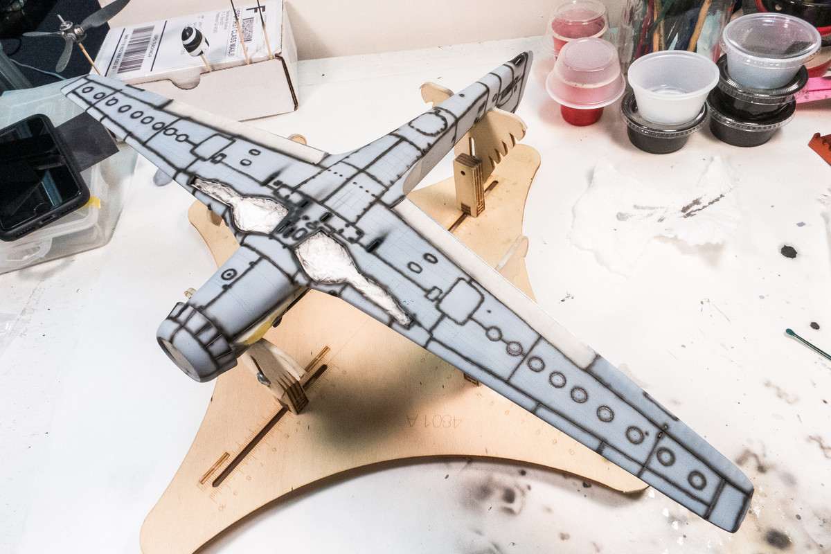

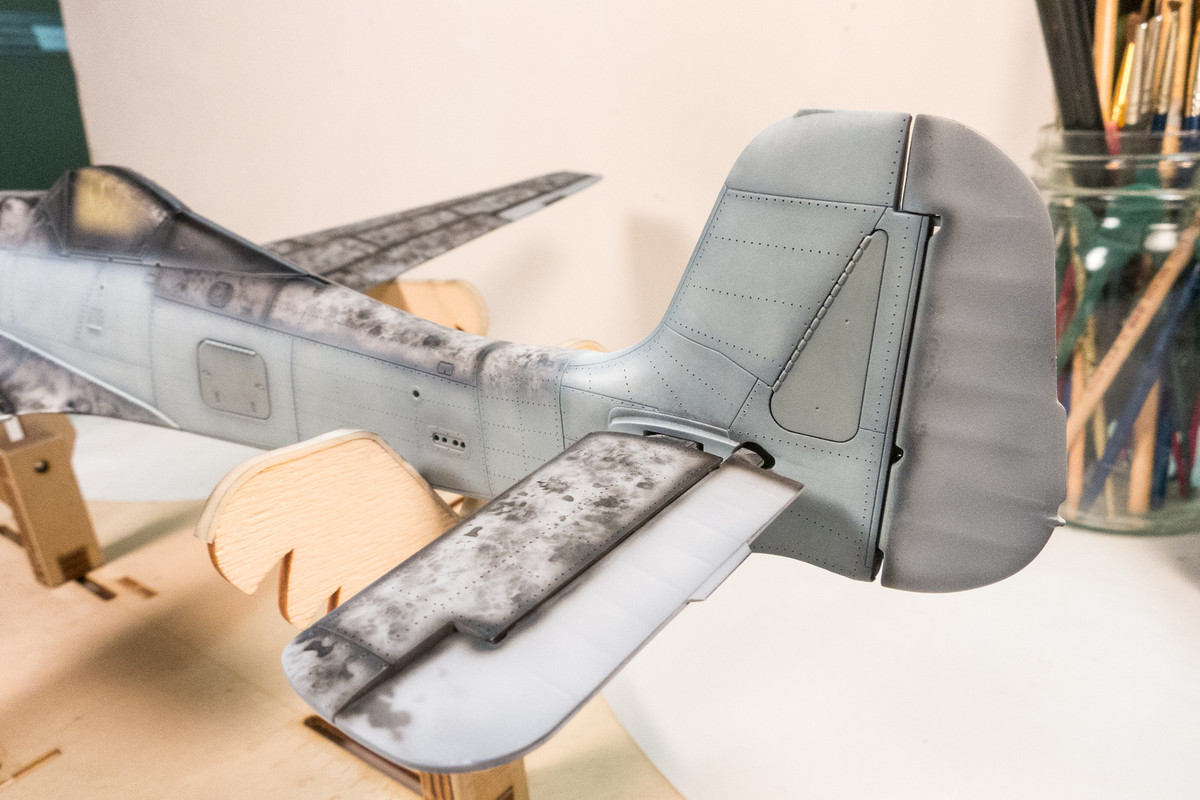

Old geezer John here to report the start of painting on the Ta152H-0. Most of my usual bag of tricks will be employed. Starting with a panel line pre-shade.
When I got to the top, I realized that I wanted to do some wing root chipping with hairspray so I had to stop the pre-shading and get some metal color (Tamiya AS-12) on, followed by hairspray.
I let that dry a full day before I finished the panel line pre-shading.
I like to apply an irregular mottled base underneath my camo colors to add a touch of depth to the model. I used to just freehand a mottle pattern but have started to use different masks to create some edge variation. The majority of mottle is created spraying through a piece of green scrubbing pad.
This is then augmented in different areas with a cardboard random pattern template designed for airbrush artists.
Pre-shading done, I can move on to the first color... the light blue RLM 76 on the undersides.

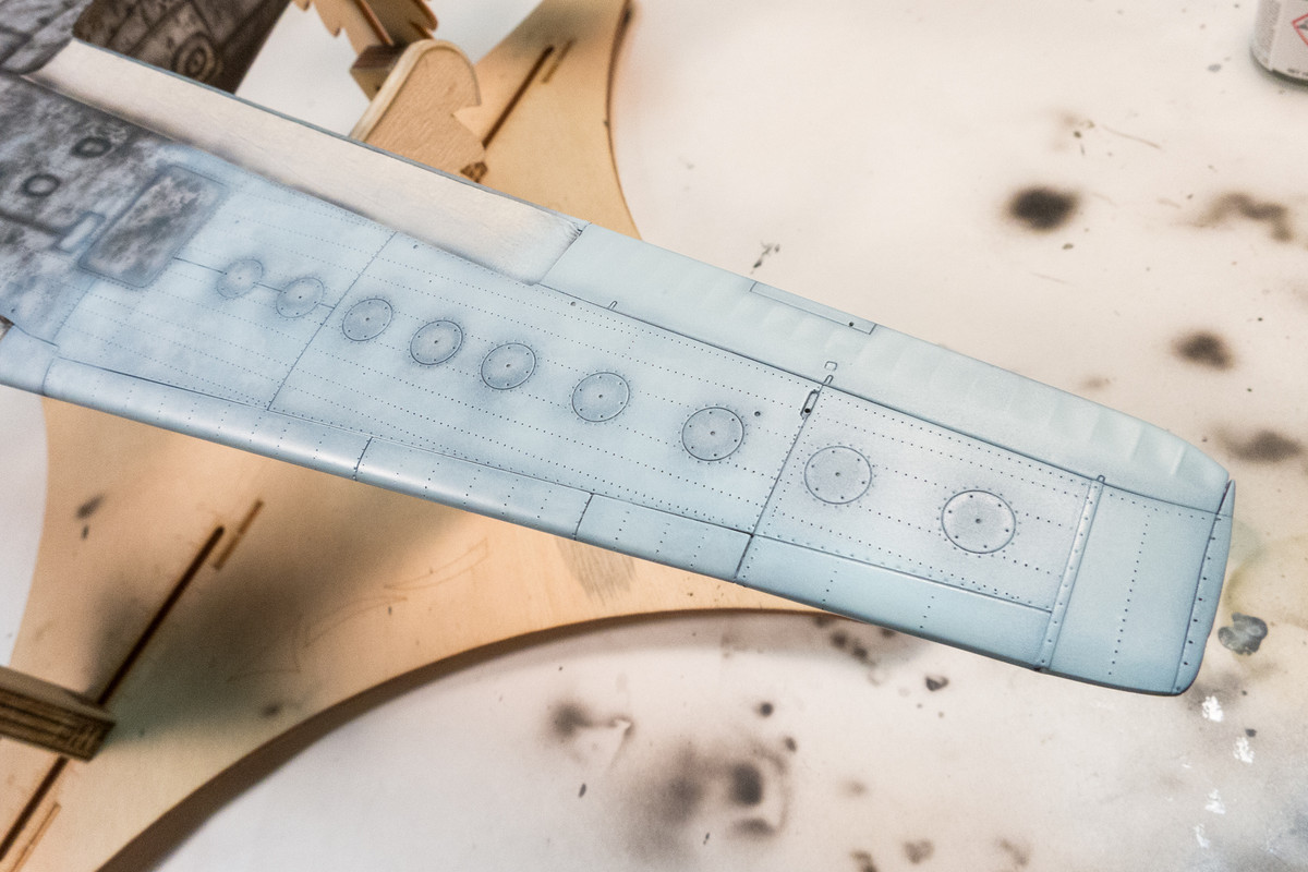

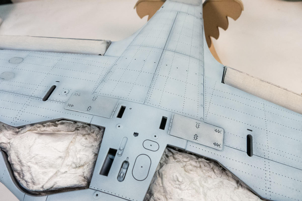

Applying the RLM 76... here we go! I'm using AK Real Colors for this shade. I really like how this color goes on. Thinned at 2:1 with Tamiya Lacquer Thinner, it goes on very smoothly with enough transparency to dial in the pre-shading effect.
I had the bright idea of using Mr Hobby Aqueous RLM 76 to provide a slight contrast to some panels.
To fully utilize the pre-shading, I paint panel by panel, trying to build up the most paint in the middle of the panel and to leave the edges just a little bit darker. It's ok to be inconsistent and not too uniform so as not create an obvious grid pattern with the panel lines.
Panel by panel, I start covering the bottom. It's also a final check to see if my re-surfacing work turned out ok and the rivet holes register under this coat of paint. I'm pretty happy with how this troublesome area looks under a coat of paint.
Ok... the bottom is done. The pre-shade effect is very subtle and usually doesn't register visually until you get closer to the model. There will other layers of weathering that will add some depth to the model later so we don't have to accomplish everything with the pre-shade. It's also important to go back to an area that you think you've finished as the Tamiya Lacquer Thinner can "bite" into the darker mottle and bring it to the surface as the paint dries.
We continue the RLM 76 up the sides of the fuselage.
Compared to the pre-shading, the application of the RLM 76, even with the highly-thinned mix, goes pretty quickly. For whatever reason, I don't like the contrast between the two RLM 76 shades on the topside. I think it'll get knocked back quite a bit by the application of the topside green colors but it is bugging me.
I like how the bottom turned out. The contrast here seems to work better and adds a bit of visual interest to an otherwise boring landscape.

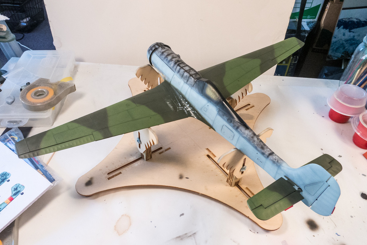

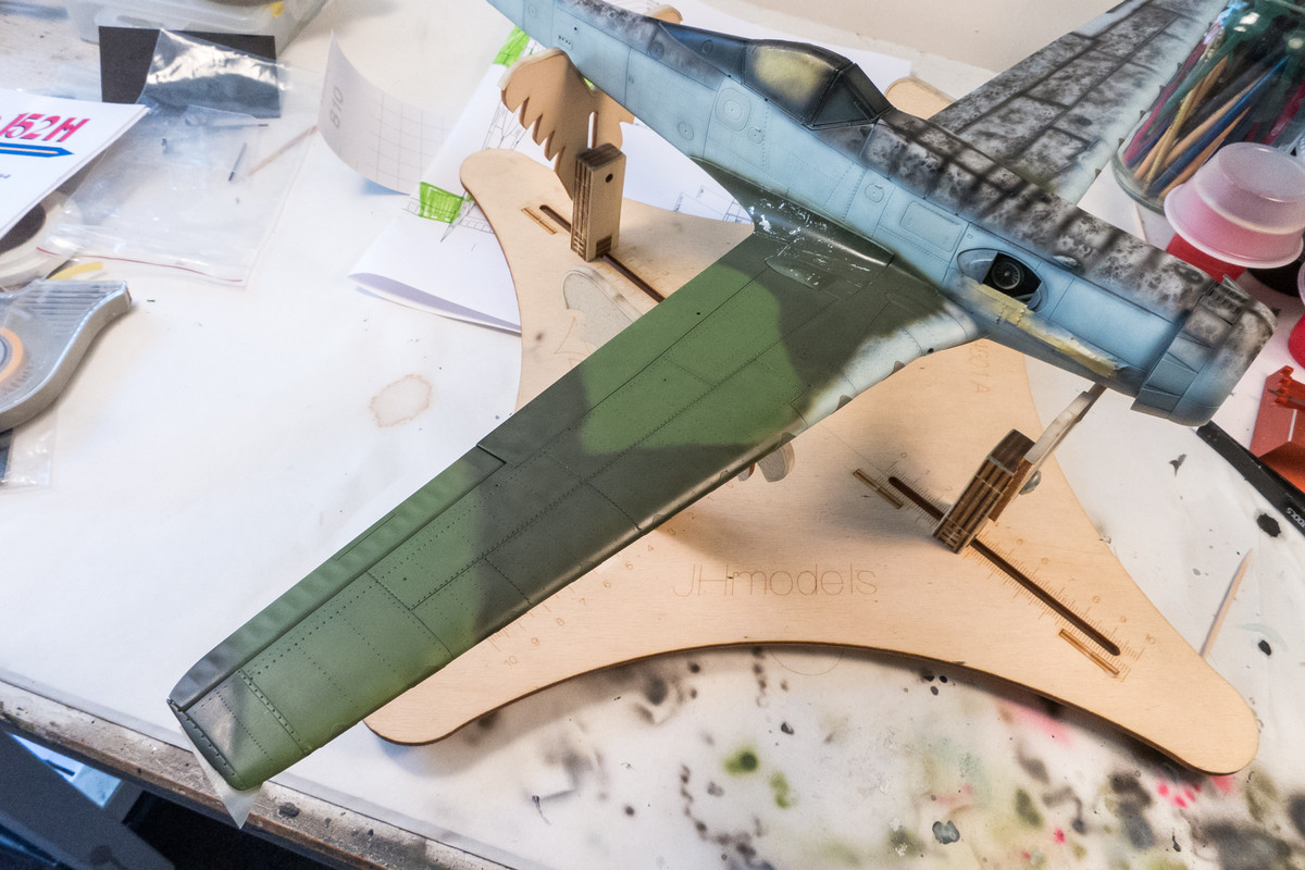

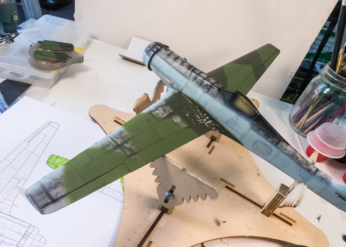

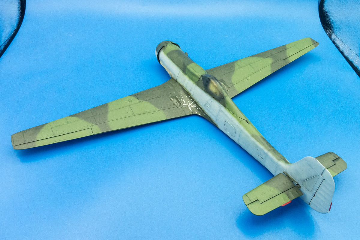

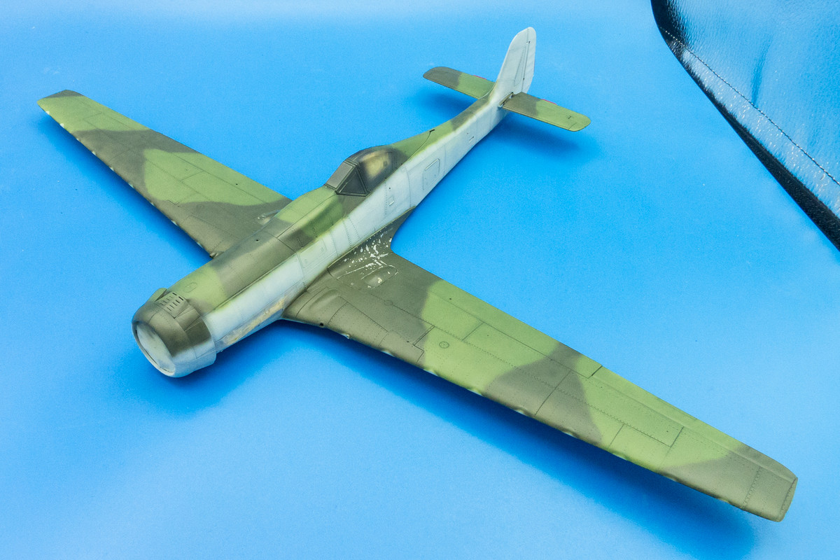

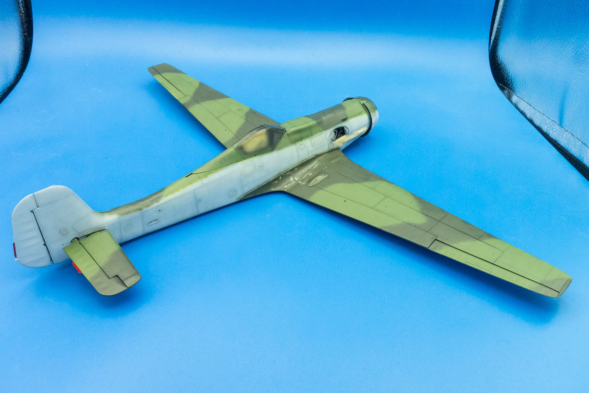

The RLM 76 has been established and so it time to put the top colors on. I am going with Bright Green (RLM 82) and Dark Green (RLM 83) for the upper colors. I've seen some variations with RLM 81 but I just wasn't feeling the Brown-Violet on this build. I don't really like AK Real Colors RLM 82 and their RLM 83 is actually a BLUE shade (long story there..) so I'm reverting to Mr Hobby Aqueous versions of these two colors, which I've used before.
I broke traditional order (lighter colors first) and did the Dark Green on both wing roots first so that I could get the hairspray chipping out of the way. After that was done, I did the Bright Green on the starboard wing. Instead of spraying the Bright Green areas on the other wing, I decided to complete the starboard wing and sprayed the Dark Green.

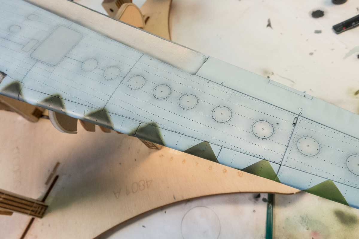

White 7 is known to have a distinctive sawtooth pattern that wrapped the upper camo colors onto the bottoms of the wings. I used the Silhouette Portrait to cut a custom mask to make things easier.
After both wings were done, I decided to soften the demarcation on the sawtooth pattern.
I wasn't getting a fine enough spray out of my Iwata HP-C Plus so I busted out the Badger SOTAR and used that instead.
I painted the 82/83 on the fuselage as well but I stopped short of the actual demarcation line as I want to study my references first.
Next, I will lower the demarcation line and do some mottle work.
