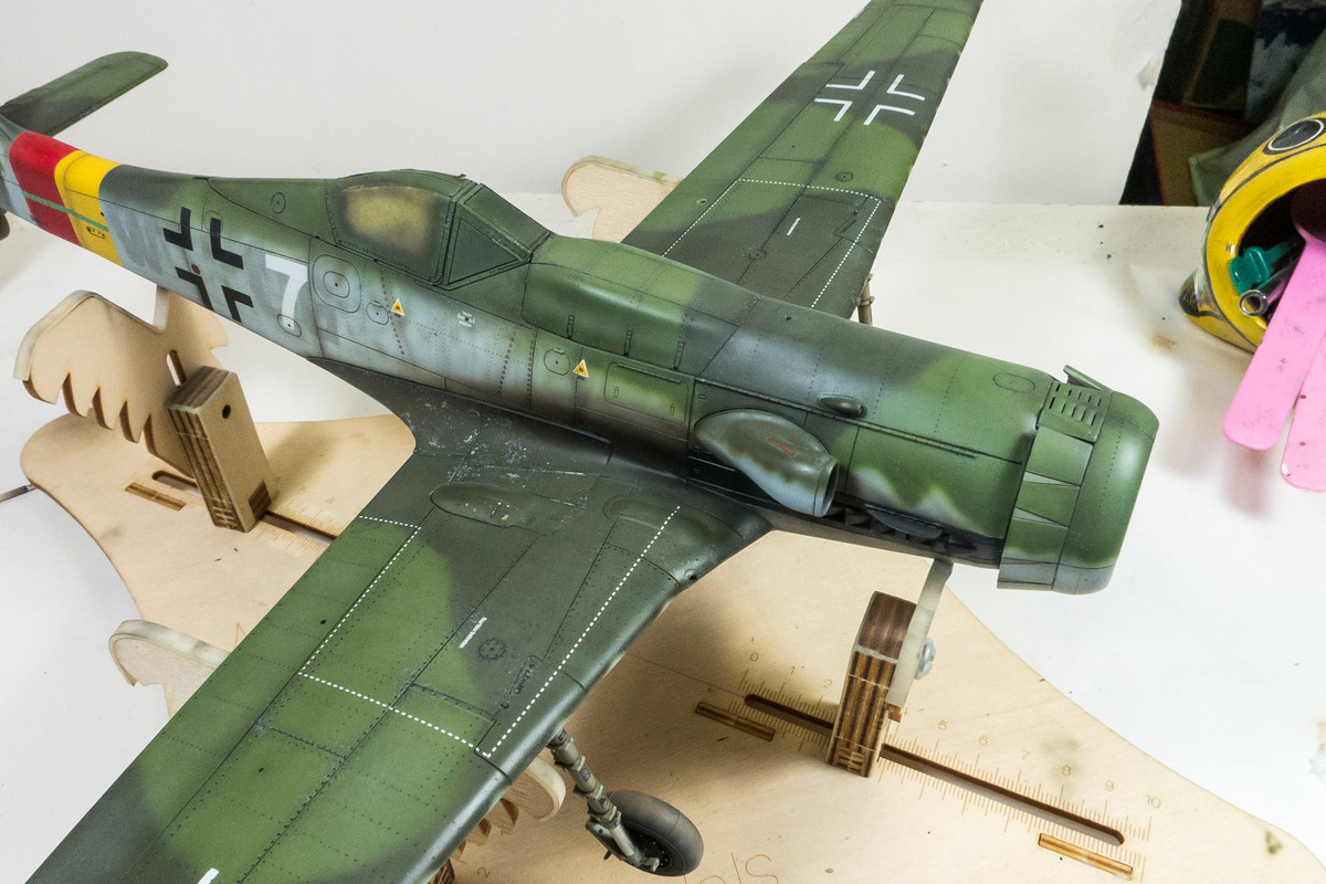

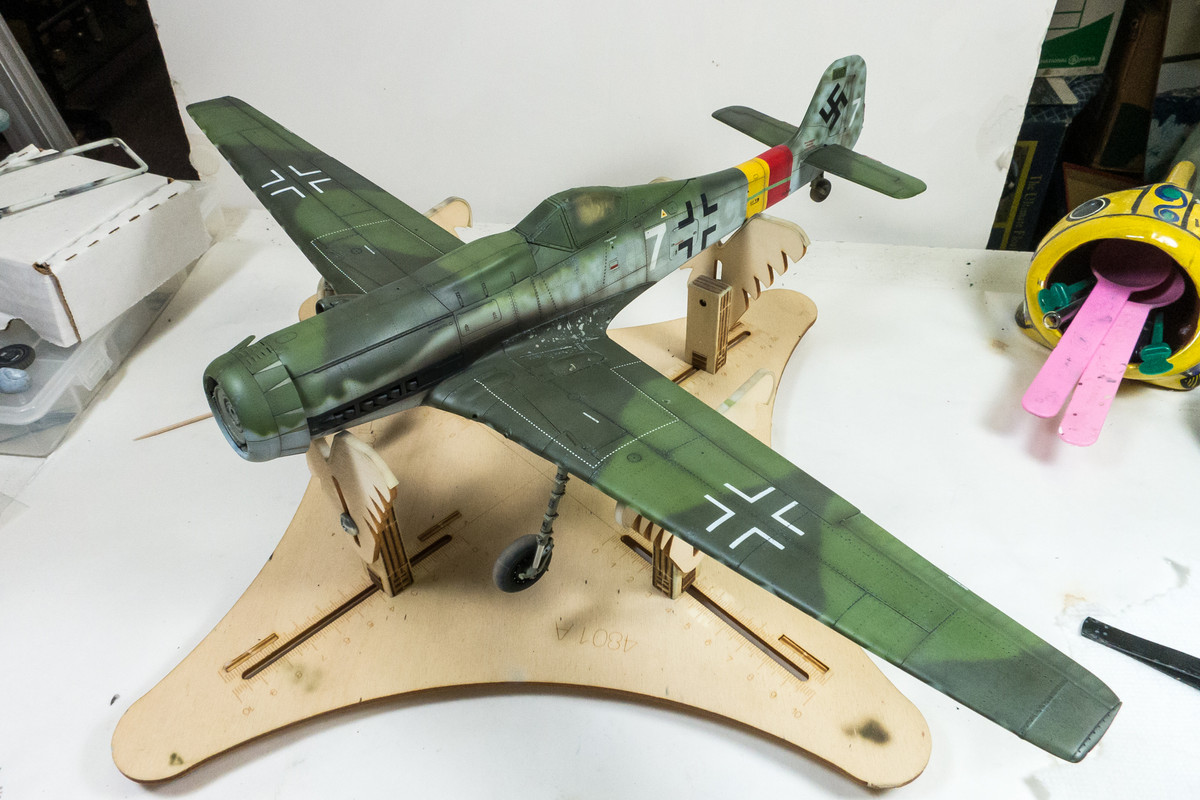

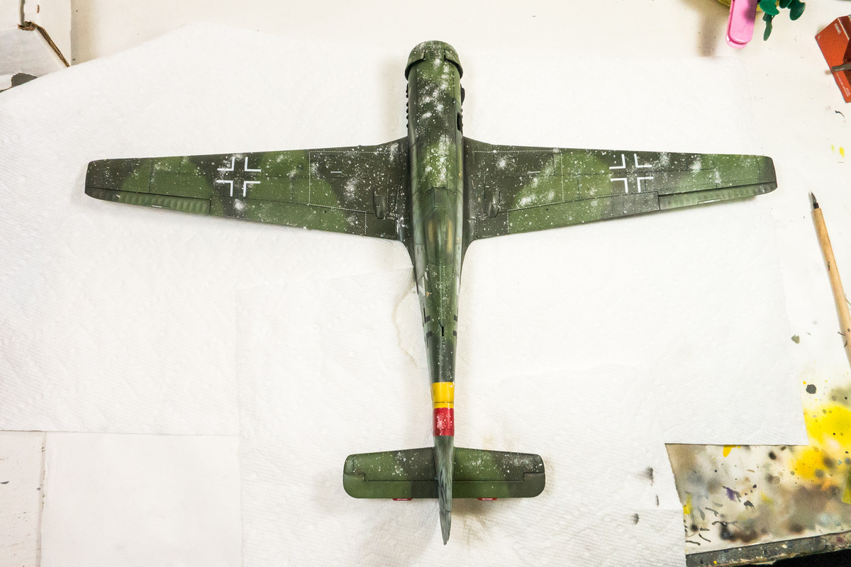

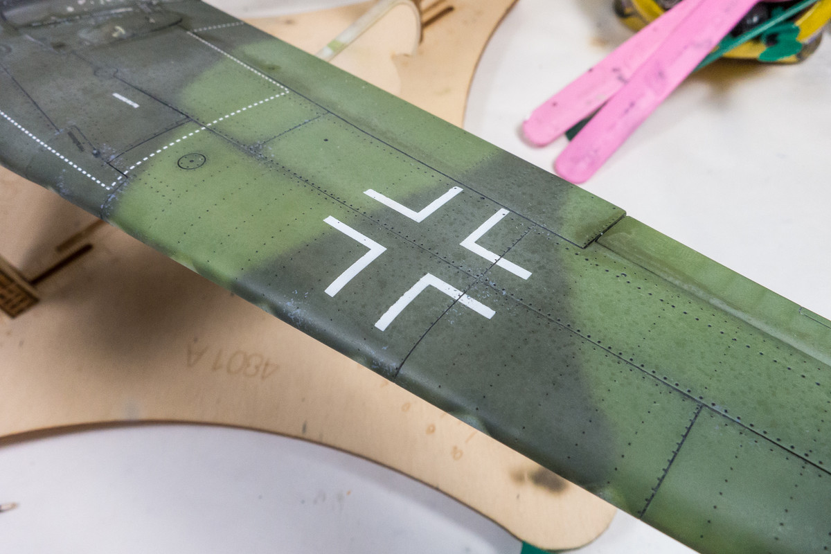

Thanks guys! This one hasn't quite given up its fight against me yet, I'm afraid. It's getting there but it has been a test of patience and will. After the flat coat, I wanted to give the upper surfaces another layer of depth and added some salt fading. This technique can be quite tricky to pull off. First, you coat the surface with a thin layer of water. And then you sprinkle salt of varying grades onto the wet surface.
After the water dries completely, you spray a very light coat of color. When you remove the salt after the paint dries, the result should be a random pattern formed by the salt crystals that mimics a surface that has been exposed to the elements. But the line between too subtle and too harsh is difficult to gauge. My first try on the Ta-152H resulted in no visible effect. Too subtle. So I tried one more time. A little more successful but I started to get a little bit of white frost on the finish that I had to beat back by spraying the affected areas with straight lacquer thinner laced with a touch of gloss.

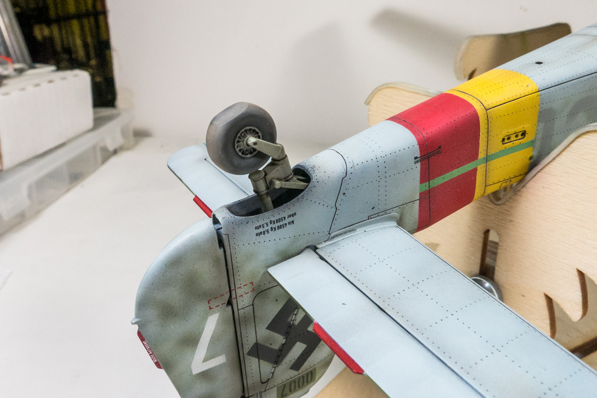

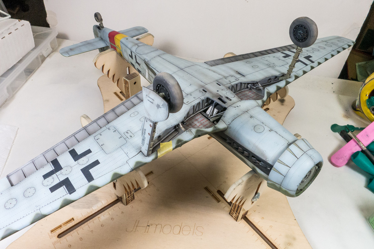

We can take a look at the results of the salt fading a little later but I wanted to move on. I flipped the bird on its back and put in the tail landing gear. No issue there although the connection isn't as rock solid as I would've hoped.

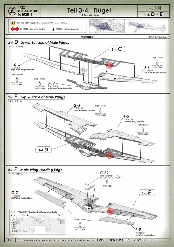

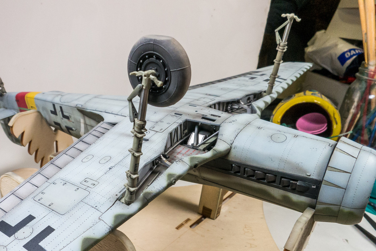

Next I attempted to install the main landing gear. This step has made me nervous ever since I saw the instructions. The fit was going to be super-tight and the way the attachment is designed, I was afraid that any attempt at a dry-fit would've locked the gear in place for good. It's a unusual method of attachment to say the least and involves an insert-and-twist move that is just reeks of potential disaster. Seriously, Z-M?
It took me a few attempts to get this to work. I had no choice but to force the legs in and that ended up crack the adjacent wing joints. Not to a catastrophic degree but enough to require some careful repair on both sides of an already highly repaired joint.
So a momentary pause while I applied liquid glue and hope that I can get a good bond. If not, I'll have to resort to thin CA glue, which I probably should've used off the bat. The tape is over the worst separation.
Good news is that the model is still in one piece.

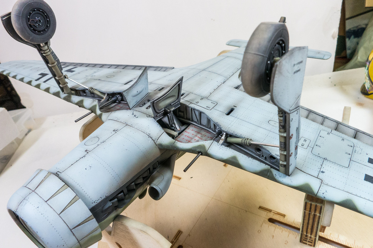

A bad design choice compounded by a modular wing structure that places multiple glue joints near this high stress area. Some of the joints are visible from both sides, meaning they are on the exterior of the wing surface AND on the visible interior surface of the wheel well.
I think I was lucky to have gotten the legs in without more trauma and was able to repair the exterior surfaces to an acceptable level. But I now have cracks in each of wheel wells that I just don't have the room to repair adequately. I'll hide them superficially with paint but if you look, you'll see them. Easily avoided if Z-M took a more practical approach to the landing gear attachment.

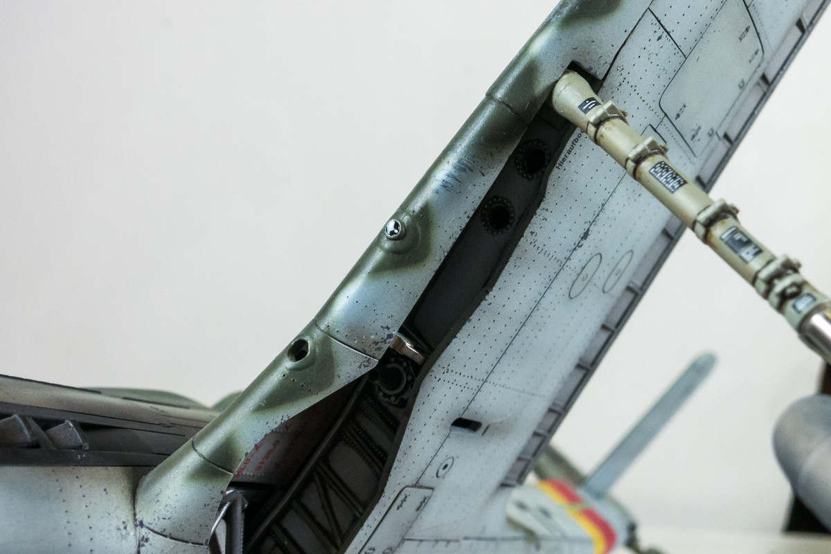

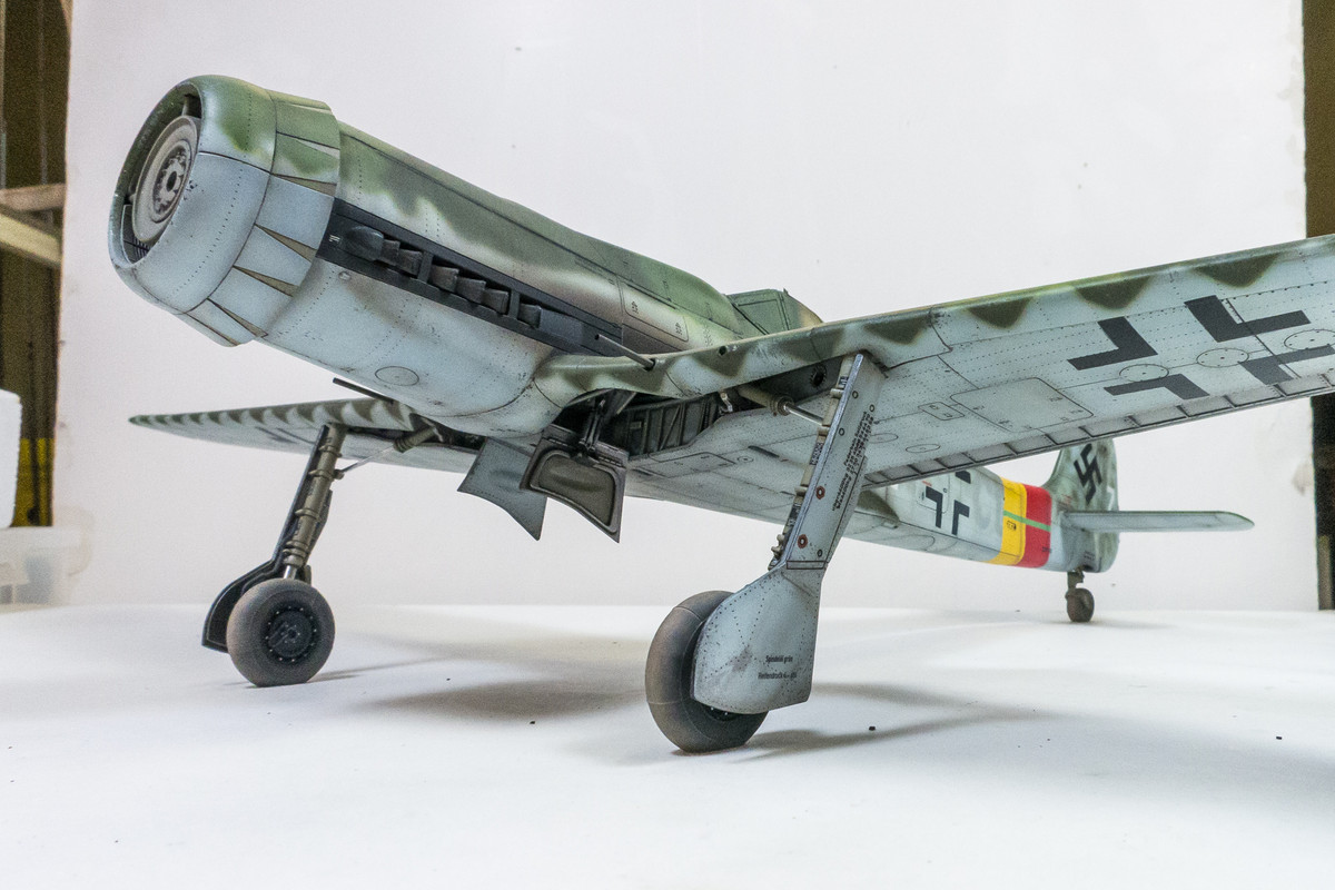

The cracked joints have been repaired, at least from the outside. This was the worst one.
I couldn't do much with the visible crack on the inside of the wheel well except hide it with dark paint and an enamel wash.
Like I said, I was pretty lucky that I didn't cause more damage with the landing gear insertion.
During the repair process, I added a lens to the wing gun camera using UV epoxy.

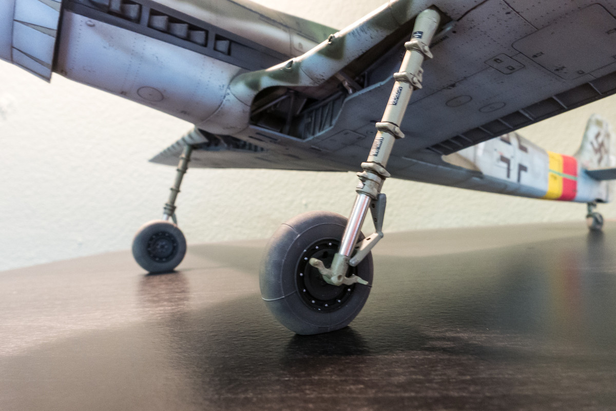

Once the repairs were complete, I glued the wheels on using JB Kwik Weld 2-part epoxy. This allows me some time to make sure the flat spots on the tires are correctly oriented on the ground.
The actuating rod and landing gear doors were glued into place.

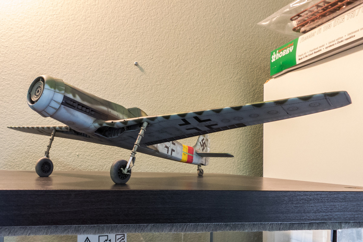

The Tank fighter is now standing on its own legs. This marks the beginning of the end of this build. Only a few more things to do before I can finally be free of this. :whiteflag:
