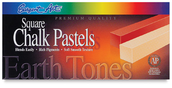

Thomas_M wrote:I know what a wash is. And I know about pastels. But, how do you make a pastel wash?
Sorry for the silly question...
Not silly at all. I make my liquid washes from pastel chalk. I just scrape some powder from an appropriate color piece of chalk, add water and a drop of dishwashing soap to break the surface tension, mix it well and presto! you have a liquid wash that you can run into recessed details like panel lines. The important thing is to use PASTEL chalk not OIL. I've had good results using these...
