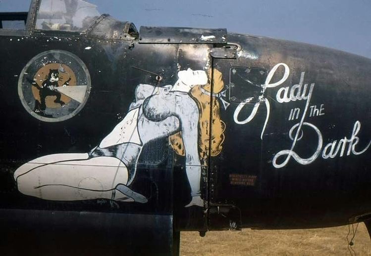

I'm building this as Lady in the Dark credited with the last confirmed kill of WWII.

God bless the nose art artists!
speedgraflex wrote:Image
