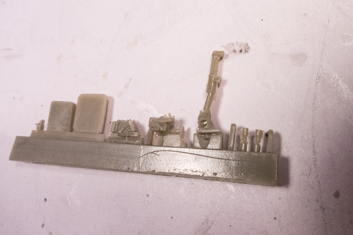

The cockpit will be replaced with Aires resin. I had very good experiences with the Aires resin cockpit for the Revell G-10 build and am crossing my fingers that this set will be similar in design and execution. Three different breeches for the gun firing through the prop spinner... does anyone know which one(s) would be appropriate for the G-6/AS?
