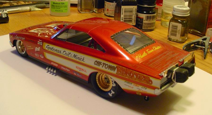

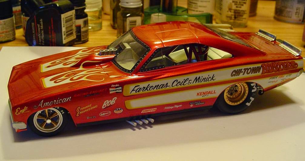

Holy COW! I love funny cars, they are my favorite race cars out there. What paint is used on the orange/red funny car? Looks super! What kit is the Dodge Charger funny car? I Must find one
You do a fantastic job with the plug wires, they look very convincing

Thanks Declan. The Revell Chi-Town Hustler kit is from about 2007/08 I think. They are easy to find on eBay. There is also a Hawaiian Charger as well. They are beautiful kits and really accurate as well. The paint on it is a Duplicolor touch up paint from any local auto parts store. They have an extensive line with some fantastic colors. It is also a synthetic laquer so just about any clear coat goes over it no problem.
As for the extra details? There are turned aluminum fittings and well as PE linkages and scratch built fuel blocks and valves. I use a LOT of reference photos to make these things. I work slowly and build up to final pieces. I use paper clips for support and for the lines to attach. Lots of drilling and eyeball engineering to say the least. I buy aftermarket plug wires and also scavenge thin wiring from things like old electronics because they are generally in scale. My bench is loaded with this stuff and the investment I have into it is something I'd rather not dwell on for too long. LOL

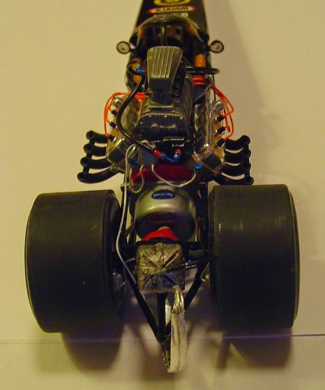

Found a pic of the underhood.
