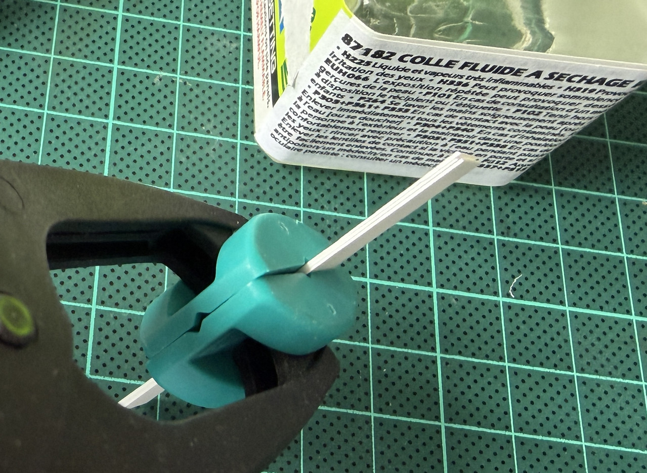

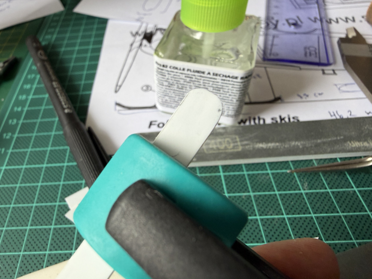

The greatest challenge with the skis is to be able to bend the tips slightly upwards. I read somewhere regarding "lamination method", in other words using a few thin styrenes (0.2-0.3 mm thick), using Tamiyas extra thin cement in between the layers and immediately, before the glue sets, bend them upwards with the help of a pen or something similar with the same curve.

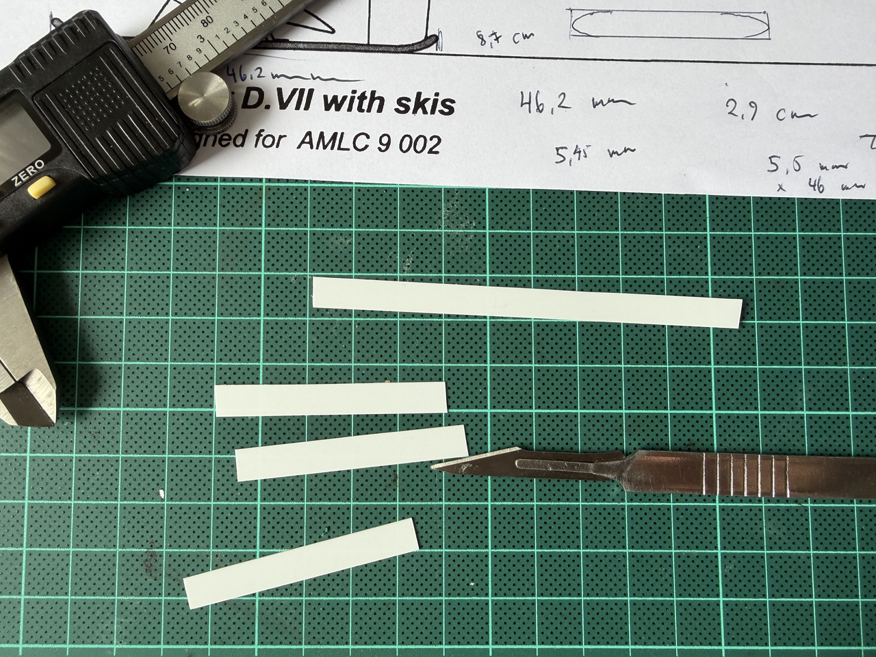

I made some rough measuring, used the styrene piece what I had (0.25 mm) and cut 3 pieces

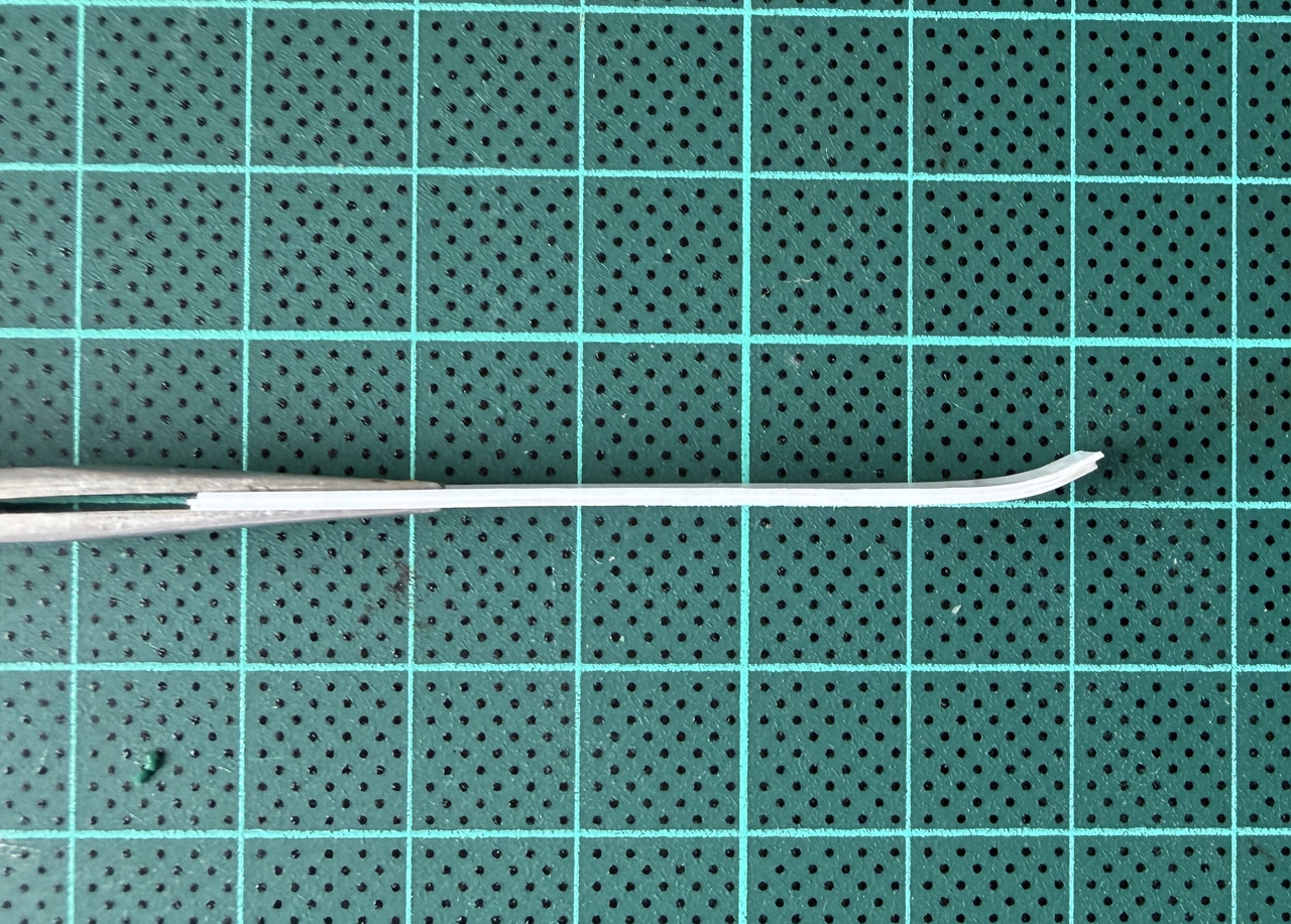

Then some careful bending of the tip

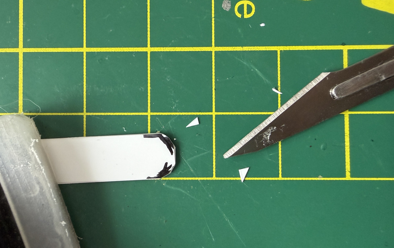

Cut into the shape
And here we have a test ski

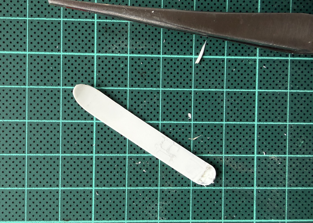

The other tip did not succeed so well, but this was after all "just a test"
Continued to try to make it more wooden
