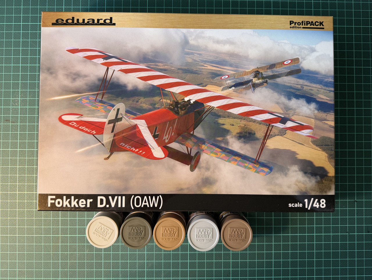

The subject of this project:

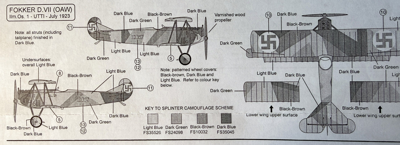

Decals come from Galdecal:
The color references differs between what is written in the reference book "The colors of the Finnish Air Force" and what Galdecal is using. In this build I trust more the information taken from the reference book than what Galdecals is telling, especially when you know the task force behind the book.
The project itself will not be a straight out of the box build, as there are a number of differencies that needs to be taken into consideration, among others;
- No armament installed, needs some scratch-building
- Mercedes D III engine, need to figure out what the differencies are with a BMW engine, at least the exhaust is different
- The fuselage of the Eduard kit I have is not 100% correct, so some kit bashing is needed.
- And on top of it all, inspired by my Fokker C.X build, this Fokker will be fitted with skis!
